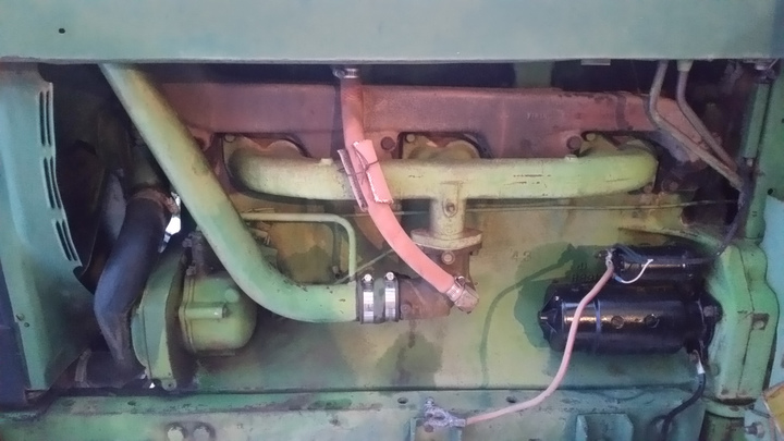

My '68 4020 Propane does not have freeze plugs.
My options seem to be a Tank type heater or perhaps a propane fired heater. ( read about them,have not seen one for sale though)
I see 99% of the affordable kits just have a plastic "T" in the kit to splice into a coolant line.
My question is, is there a better way to do this? If, so just what plumbing adapters and other fittings would be needed to install a tank heater?
Are there any good photos of what was done to install this heater?
There is a good bit of room on the right side of the block to mount the tank heater.
DEERE made/makes a tank heater kit, and there's aftermarket options.
Tank heater mounts below generator.
Bottom line of tank heater crosses front of engine and connects to block drain on opposite side of engine.
Outlet (top port) of coolant heater connects to port in center of head between sparkplug that now has hex plug in it.
There are lower hose heaters made. But it may not have room for that either ?

On my 4020D, I mounted a tank heater right next to the block drain, and ran the outlet hose right up over the top of the engine into the pipe plug in the enter of the head. Works good.
