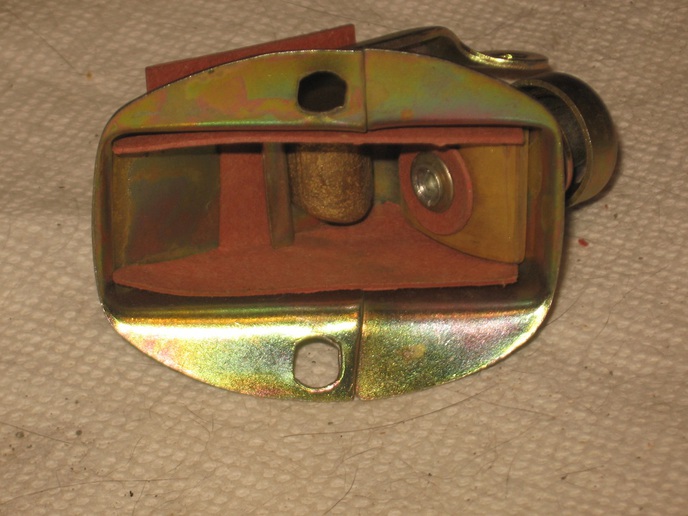

my john deere 40 has been wired by the prior owner 6v negative ground and has been running just fine, however i wanted to put a new starter switch on it so i ordered from yesterdays tractor switch and it seems to arc on the pull rod, so i took the new one off and put back the old one and no problem other than it's a bit rusty and sticks when pulling
do i have a faulty starter switch?

You might consider inspecting the insulation on the inside of the switch.
Take a look at the photos below.
a271120.jpg" width="650"
Make sure the copper stud on the push button does not come in contact with the two sides of the metal housing.
a271121.jpg" width="650"
Make sure the end of the push button does not come in contact with the copper stud.
a271122.jpg" width="650"
Make sure the copper stud connected to the battery cable does not come in contact with the inside of the metal housing.
"[b:654c4848f0][i:654c4848f0]<font color="#6699ff">do i have a faulty starter switch?[/i:654c4848f0][/b:654c4848f0]</font>"
IF the new switch "[i:654c4848f0]seems to arc on the pull rod[/i:654c4848f0]" AND you "[i:654c4848f0]took the new one off and put back the old one and no problem[/i:654c4848f0]", THEN the new switch could be a faulty starter switch.

thanks for all that information that is great!!! i put the new switch back on and found continuity from the stud to the case with out the button pressed, i inspected it and all looks well insulated but it has to be a bad switch doesn't it?
thanks again
dave
"[b:654c4848f0][i:654c4848f0]<font color="#6699ff">found continuity from the stud to the case with out the button pressed[/i:654c4848f0][/b:654c4848f0]</font>"
Probably need to exchange it for another one if possible.
