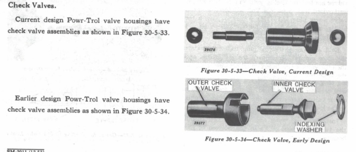

Anyone have trouble with PowerTrol valve on a 50 60 or 70. My 70 rockshaft will not stay up anymore. The piston O-Ring is brand new. When I lift my plows for example they drop back to the ground quite fast.

The piston,Oring and gasket are all good I pulled the back housing to check. Even pulled the pump thinking somehow it might be involved of course it was not but all rebuilt never the less. It has to be something about the valve, this summer I plan to do some pressure testing and make sure the adjustments are all where they are supposed to be. I was hoping someone might have had the same issues and could steer me in the right direction possibly for an easy fix.

 Re: PowerTrol in reply to mdross, 03-13-2018 08:09:44
Reviewed the Hydraulic Equipment SERVICE MANUAL John Deere Waterloo Works SM-2011 (Dec-52).
Take a look at the WILL NOT STAY IN RAISED POSITION troubleshooting list below.
third party image
Note the second item Check valves leaking. Reseat.

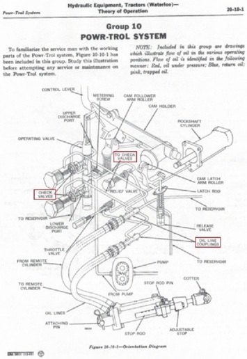

Take a look at the Orientation Diagram below.
third party image
Note the CHECK VALVES, TO CHECK VALVES, and OIL LINE COUPLINGS.
Take a look at the TESTING CHECK VALVES FOR LEAK topic below.
third party image
third party image
third party image
third party image
third party image
Hope this helps.

Thank you for the suggestions, once all this snow is gone will get out to the back barn and focus on that valve. Is the valve lock available or will I have to machine one up?

 Re: PowerTrol in reply to mdross, 03-14-2018 04:08:32
"Is the valve lock available or will I have to machine one up?"
This is the only information I found on the valve lock.

Thank you James looks like there is another tool I need. I have a spare valve it's time to get it out and start trying to figure this thing out.
