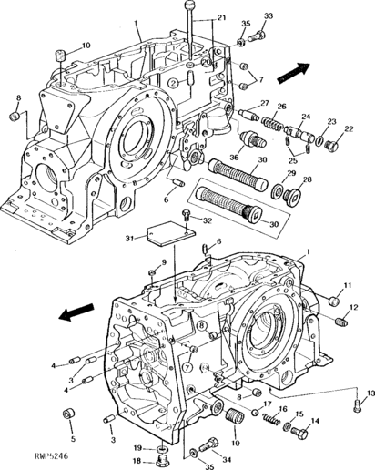

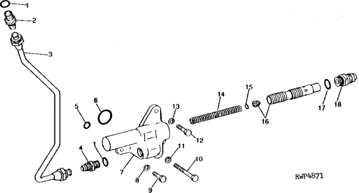

 1530 JD Hydraulics won't work in reply to Tx Jim, 09-01-2013 14:36:58
Quoting Removed, click Modern View to see
Isn't there two oil control valves in the transmission? The 145psi relief valve that is accessible on the side of the transmission case which sends "excess" oil to the front pump? 2nd valve is the divert if filter is plugged unit at the trans oil filter?
[Log in to Reply]  [No Email]
Tx Jim
09-02-2013 09:21:38
Report to Moderator
 Re: 1530 JD Hydraulics won't work in reply to buickanddeere, 09-02-2013 08:14:21
Parts keys #24-27 are the filter relief valve for low pressure(150-165 psi)
third party image
This is the pressure control valve(parts key #16). It closes at about 1700 psi to ensure PRIORITY hyd oil for steering.
third party image
Then there's another trans pump pressure control valve in the shift cover on tractors with hyd pto & hi-lo.
