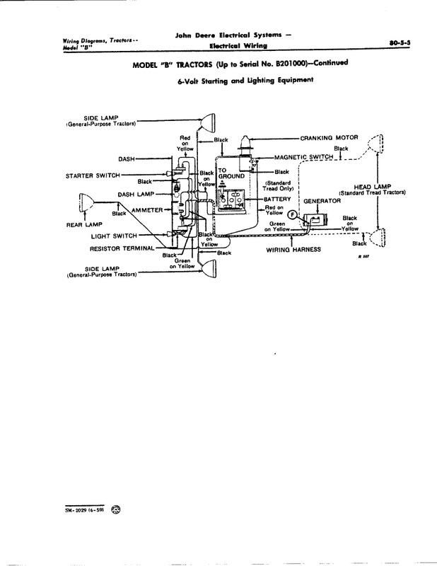

need wiring diagram for 1947 john deer b all ready have a manual but no wiring diagram. need to fix charging problem on my eighty year young dads toy! any help would be appreciated. thanks!

thanks guys for all your help. I should be able to get him fixed up for the next parade with the diagram you sent.I look at this site almost daily and enjoy seeing how you guys really kick in to help each other. Thanks again! deerlover....

 Re: 1947 JD B in reply to deer lover, 11-07-2008 12:59:23
third party image
This diagram is for a B up to 201000 SN and the 1947 starting SN was 191303 so it should be the one. If you go instead to the URL Link of M Mans Wiring Diagrams be sure and drag your cursor over the picture to enlarge it to full size for viewing or printing. If you need my complete Troubleshooting Procedure for non charging, go to this URL
