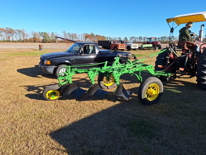

crsutton81
11-19-2023 13:32:27
Report to Moderator
Third Party Image
When transporting this plow down the road, it tends to have the tail wheel violently shimmy to the point that the plow will unhook itself from the tractor if there is much speed involved. Has anyone experienced this or come up with a solution to curb the problem ? There is a plow day held locally every fall that we would drive this equipment to if we could quickly and safely get it there.

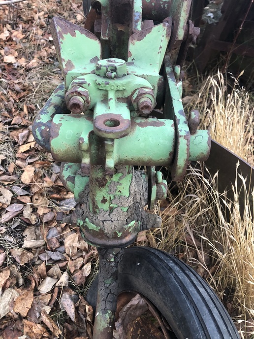

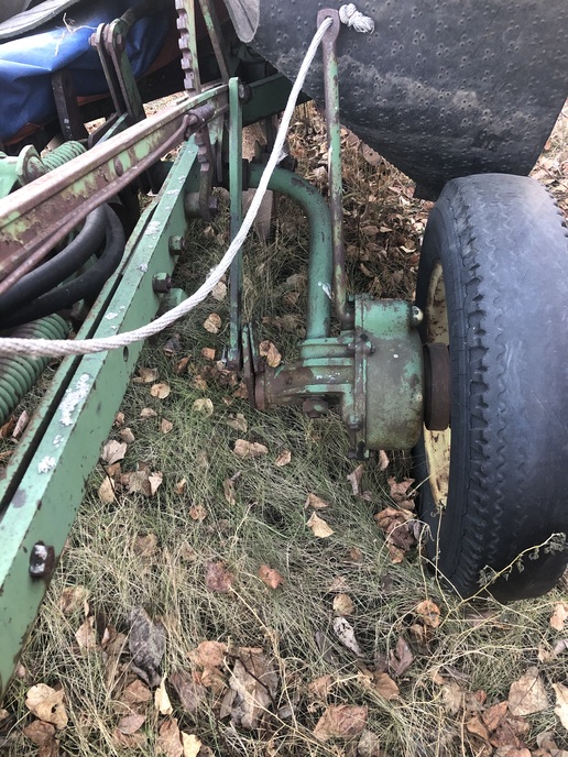

rustred
11-20-2023 16:36:45
Report to Moderator
 Re: JD 55 ABH plow in reply to crsutton81, 11-19-2023 13:32:27
here is the small furrow wheel lock set up.
Third Party Image
Third Party Image and its the old rope power trip set up, 4/16 with blacksmith shares.

crsutton81
11-20-2023 20:00:15
Report to Moderator
 Re: JD 55 ABH plow in reply to rustred, 11-20-2023 16:36:45
Thank you rustled. It makes sense after seeing a good picture of the way it's setup. I wish we could find the correct parts to change this plow over to enable locking the tail wheel.

rustred
11-20-2023 20:30:32
Report to Moderator
 Re: JD 55 ABH plow in reply to crsutton81, 11-20-2023 20:00:15
Take those pieces to a welder and he can make that. Easy enough to do.

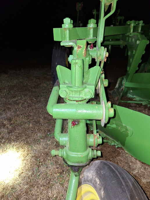

crsutton81
11-19-2023 18:09:28
Report to Moderator
 Re: JD 55 ABH plow in reply to rustred, 11-19-2023 16:43:08
Third Party Image
Here is the tail wheel assembly. The typical travel distance my son goes is approximately 3 miles one way to get to most of his fields. As far as speed, 4th gear maybe half throttle on a Farmall 300 is about the limit before any chaos begins. We have some paved roads in bad shape around here. A un graded dirt road rides better than asphalt paved roads. I would like for him to be able to go on down the road with it to limit his exposure to traffic.
[Log in to Reply]  [No Email]
rustred
11-19-2023 18:18:43
Report to Moderator
 Re: JD 55 ABH plow in reply to crsutton81, 11-19-2023 18:09:28
It does not have that set up for the pin. Could probably make it. Will try to get u a pic of the Set up Tommorrow.

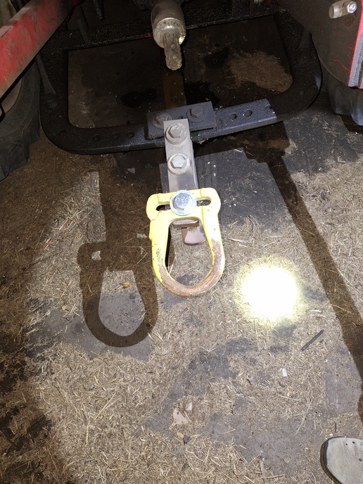

Plowman
11-19-2023 16:28:06
Report to Moderator
HI That is a IH hitch not factory Deere hitch

Leroy
11-20-2023 09:31:28
Report to Moderator
 Re: JD 55 ABH plow in reply to rustred, 11-19-2023 16:23:03
That hitch is exactly what I had and to go down road do not raise to full height, only far enough that the rear bottom clears the road, That tightens up the lock for the wheel, will still do some but not as much as if you raise it full height. I got mine used in 1970 and used till had to quit farming, Best plow I ever had, 3-12 inch hydrolic lift. It had the drawbar shown on yours that is a non release type of hitch that is to be connected to the hand clutch to dissenguage clutch to stop if you hit something. I only had part of it and junked it and put on a release type of hitch designenen for Farmall or Oliver or others. That hitch is designed to stop tractor without unhooking hydrolic lines without a breakaway connection in hoses > could hand sharpen the shares with our forge but was so much harder to do that we took them to a place that could properly sharpen them. Our forge was just too small and we did not have the power hammer to do them. 2.5 inch cylindrr marketed for a B Deere but plowed with a 1951 A. We also had the Yetter coulters on all the plows and it made day and night better on all over the orignal Deere coulters.
David from Kansas
11-19-2023 17:44:48
Report to Moderator
The early 55ABH plows did not have that anti-swing/tail whip feature but it can be put on. I may have an extra one. Can send picture if you want. In the old days, we would take a piece of wood about 12-18 long and 1.5 square and drive it in the opening on the top of the tail wheel swivel. Email is open.

crsutton81
11-19-2023 16:09:28
Report to Moderator
 Re: JD 55 ABH plow in reply to DeltaRed, 11-19-2023 15:32:18
Third Party Image
Third Party Image

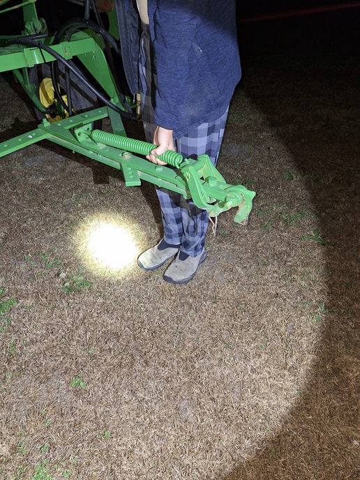

crsutton81
11-19-2023 16:16:32
Report to Moderator
 Re: JD 55 ABH plow in reply to crsutton81, 11-19-2023 16:09:28
Sorry Delta, I hit the wrong button uploading pictures. Anyway, this is the hitch on the plow. We are not sure if it is the correct one or not, but it has been on here for a while apparently. Grayson used this plow for the 2023 growing season after he had cleaned it up and I painted it for him. I could never find a pin hole to lock the tail wheel straight, nor find a good way to makeshift tie it still in a straight line.
