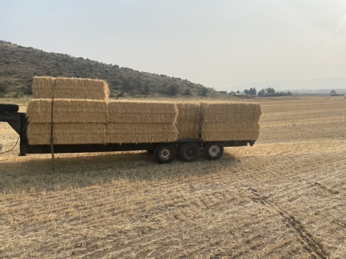

Its just me and I am not a speedster. I bale small square 14x18x42 and try to get as least 80 pounds. 14 ft swather means 3 bales per minute in third gear with 4010. I usually start about 10 pm and bale until it gets too dry, or the morning dew makes it too wet. I stack with a 1036 bale wagon. I quit when it is time for whisky. The rest of the work gets done the next day. Retired , 75 and not working my butt off any more. Bud
