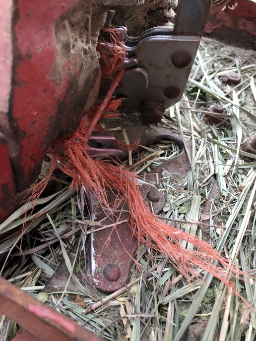

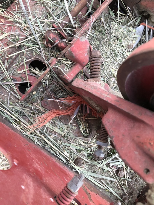

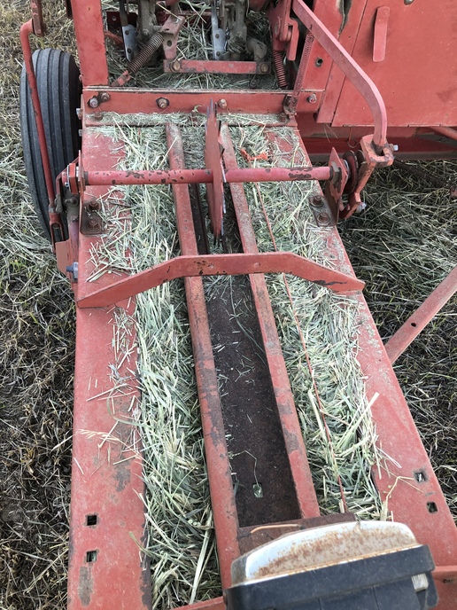

Last winter I picked up an old IH 430 small square baler. Yesterday I baled a very small field and it made 35 nice heavy tight bales. This evening I started baling a 40 acre field, hit went through the first 15 bales and then it started messing up on the knots on the left side. I had to flip the knotter up and dig a Birdsnest out of baler twine off of the bill hook. I was able to make another five or seven more bales and after that it did the same thing again. Any ideas on what I need to do to fix it?
Dull twine knife;rough/grooved bill hook..... You need to order an owners manual.ASAP. A baler knotter is too complicated to just 'wing it',especially for a 'newby.Order from Binder Books. Less than 40 bucks.

-- "even if it is threaded right, pull out the twine and rethread it." "When you do, don't just reach in there like I did the first time, get a good light and crawl under there where you can see what you're doing. The fingers have several different 'ins and outs' for the twine to follow and they have to be right." My experience in going from the 45 to a New Holland was that the 45 had a much more complicated twine path so I'd say if you're used to the New Holland pay extra attention to this.
-- Twine knives need to be sharp, like razor sharp if possible. Mine were pretty much worn out.
-- Twine knives have little shims to hold them at the right angle. If they get loose or the bolts come out the knotter will not work.

You have one of the best balers ever made... as suggested try string knife for edge also check eye in needle for wear , what is really needed is empty baler then trip knotters while someone is pulling string and observing

I have a 440 all twine . I love it . Id looosen the bill hook tongue tension off About one nut flat maybe two . Make sure no grooves or spots on the bill hook
I was able to look at the knotters this afternoon and I cant see any wear or grooves on anything. The paint is still on everything looks like baler hasnt had many bales through it. Unfortunately the bill hook tensioner bolt was already backed off so the nut was flush. I did loosen it couple of turns and that helped enough that I was able to get about 30 or 40 bales before it got all bound up again. It has just the plain cheap orange twine that everyone sells in it and Im sure the twine has been sitting in the baler for at least a year or two. I was thinking about going down to the New Holland dealer and getting some of the nice softer yellow twine to see if that helps. I would try sisal if I knew it would work but I know its also not the greatest thing if youre storing bales outside
Though it's not the best picture, it looks like your knife needs a good sharpening. They need to be darned near sharp enough to shave with. You should be able to order replacement blades through CaseIH, but if memory serves.... they want a lot of money for a dinky little replacement blade.

From your photos it would appear that the bill hook is not grabbing both twines or the twine knife is not cutting the twine.

Thanks for all the info everyone!!! I tried sharpening the knife and that did help a bit, I was able to get about 20 bales at a time before I had to stop and unbolt the knotter to clean it out. I went down to my local dealer and got some of the nice yellow HW brand twine to put in it. Once I did that I didnt have any more problems on the last hundred or so bales I did for the day.
