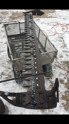

So I picked up a new to me new idea model
30a sickle mower the other day. I've got a
couple acres of pasture to mow for my
amateur hay operation. (It's more of a play
outside with old equipment thing).
So I know the blades need to be replaced
and there cheap enough but what about the
ledger plates and rock guards? Should those
be replaced for reliabilitys sake? What's
on it now have the new idea logo cast into
them I'm guessing original? Nothing at my
local fleet farm looks like them. Can I use
the double style in place of two singles?
Currently the cutters don't even make
contact with the ledger plates ive got
about a 1/4" gap which doesn't seem right.
I'm currently waiting on a owners / parts
manual to come. But I'm afraid it's going
to be filled with antiquated part numbers
for obsolete parts and I'll have to make
due with some universal parts anyhow.
Anyone have any experience or tips on this?
yes the sickle should run close across the plates first thing is the end of mower beam all the tips of the guards should be in a straight line ; if they are not that needs to be adressed first . then the sickle hold downs need to be snuged up
Take one of the guards with you to make sure they will bolt up the same as the ones currently on it but double should work fine. If you can't find the right ones try this site...
https://www.cuttingcomponents.com/. They have a little of everything. You can buy different hold downs that are adjustable and are easier to work with but if you're like me and don't want to spend the extra a good smack with a hammer and it should snug them down. It also could be that your guards need to be bent up also. You can use a good sized chunk of pipe to bend them slightly upward. The blades can't be tight on the guards but touching is what you're looking for. The stand by was if you can slide a piece of paper between the guard ledger and the blade you are in business. Learned a lot from this site and youtube for my IH 120. Good luck!
I put the new style guard on my John Deere no.8 per the advice of the fine fellows on this board . I can cut hay as fast as I can stay in the seat . Hopefully you can do the same on yours
Get your manual, see if there are wear plates and what other parts are there to wear out. You're going to have to refurb the whole thing. The bar has to be straight and free of bends and kinks, the wear plate bed smooth and even, the same for the knife bed and the underside where the guards mount. I'd recommend double haybine guards, top serrated sections and you have to make sure everything is lined up right. The hold downs need to hold the sections DOWN and your manual should give you the needed clearances. You'll also have to check the wear in the pins that determine your bar lead and adjust/replace what you can. Oil and grease the crap out of it and be prepared to adjust things as you use it. Think of it as a 7 foot long row of individual scissors each needing to be just right to work well.

There are wear plates under each of the hold down clips. They support the back of the section bar and keep the sections from lifting off the stationary knives.
Probably unnecessary advice, but you'll need to have the bar in the down (cutting) position to check it out. An upright bar is not at all close to one operating in the down position. kelly
