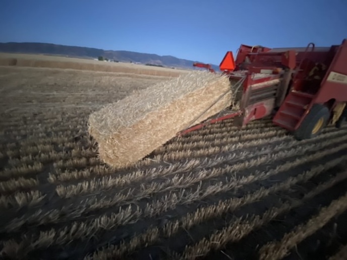

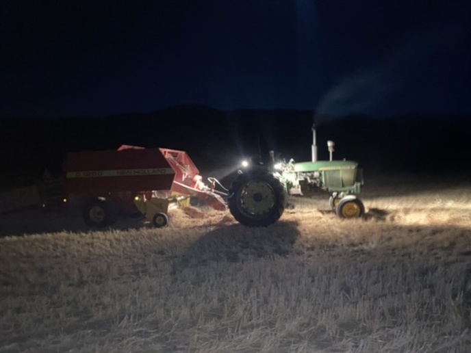

New holland d1000 makes a 2x3 ten times better to haul and stack than a 3x3 because they are oblong they sit on a truck or trailer a lot nicer nothing to them they are just big little baler they weigh just under 10,000 pounds with hay in em they make up to a 700 pound bale is the heaviest I make
