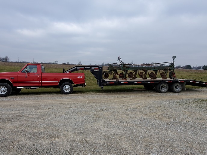

Got my plow home today

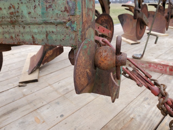

U am guessing theses are Oliver type hook
ups?

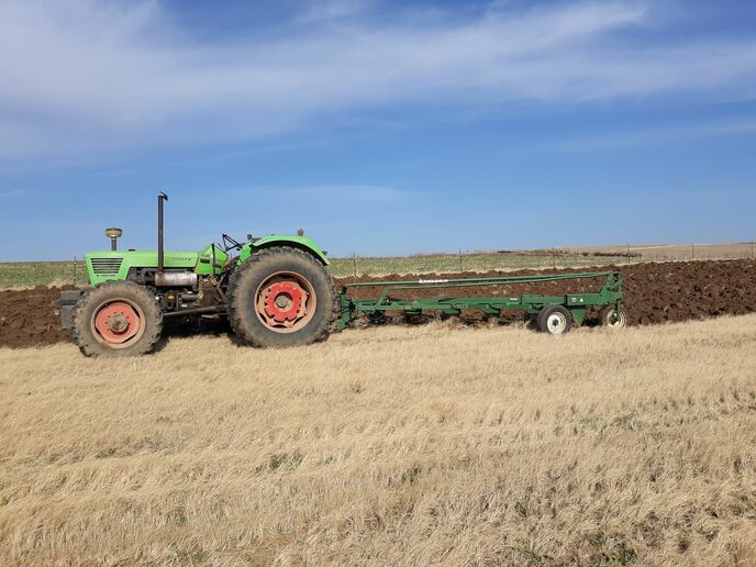

Nice plow. I have a few different Oliver plows. I am pretty sure my 6 bottom (shown in the pictures) is also a model 566. Oliver made excellent plows.
Yes some Oliver tractors had 3 points with "claws" to hold the 3pt ball. I am not an Oliver tractor expert but I have seen them. With that system you could back up to the plow, raise the 3pt, and drive away. We have one Deutz that has the Walterscheid claw ends that are a very similar. They are now standard on most larger tractors it seems, especially if they are of European descent. We love them. We have a discbine that hooks to lower links of 3 pt. We leave the balls on the discbine all the time, but just back up the tractor to the discbine and pick up 3 pt and drive away (well still have to hook up the pto and hydraulics). On your plow, those are guides to help get the arms in the right position in under the "claw" on the 3 pt arm.

You have a nice hauling rig too!
Nice plow! we had a 1850 fwa and a 2150 I think it was for a few years both had the claw 3pt arms that took that ball,, never seen a implement built for them thats pretty dang neat to see, I think you had to latch the ball in manually after hooking on,, but its been a a number of decades since I used one,, I have a White 548 also have a CASE/White model 400 plow, we sold a lot of them new good plows
The balls and guides come off and live a cat 2 pin. I don't have an Oliver tractor so maybe someone on here can use them. The plow needs a few parts, do you know wheres a good place to get them? Also there is wires with a 3 pin connector thT goes to the luft cylinder, any ideas whats thats for? I know nothing about olivers!

That guide to get the claws in to the balls are a nice addition! I've never seen those before. I usually have to use a broom handle to guide mine in.

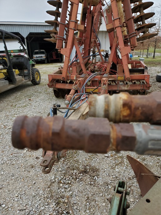

It will be in the morning, I left my laptop at work this morning and can't log into my account of my phone
Are theses tips for olivers?
Not so far as I know. Most have Pioneer. There was some other odd thing on the old Fleetlines and what not, but that wasn't it.
Yes, not sure on the years, but I know they were used on the 1800 series tractors. Aeroquip brand.

What plow? LOL All I see is a NICE looking truck!! At least around Missouri anyway, you don't see the OBS Fords without wheel well rust and the cab corners starting to rust out.
That truck has made several trips to Missouri. A couple to Sikeston for parts and throwed rolls and several to Osage beach to fish. Most of the time it sets in the garage,covered.
