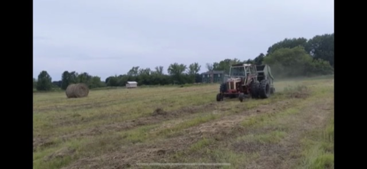

I’ve never seen one but now I want one
John Deere 510 in action
Read the manual, do not take your eyes off the bale. Make sure the roll starts all the way across. Only bale dry hay, it absolutely will not bale damp hay( don’t even try). The 510 likes large windrows, I normally bale windrows that barely go under a row crop JD 4020 in fourth gear. Run good belts. Ok for a small operation. If you can afford better I would go that way. Remember you are the “bale master” from starting the roll to adding the twine.

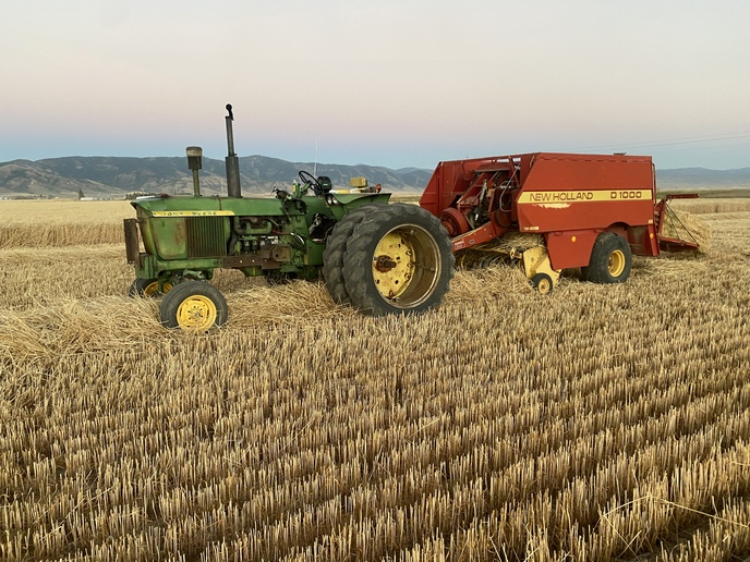

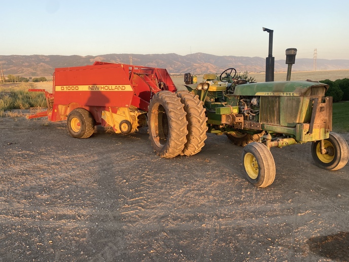

I was told my new holland D1000 wasn’t worth dragging home
either but it puts up a nice bale and works fine for what I want
