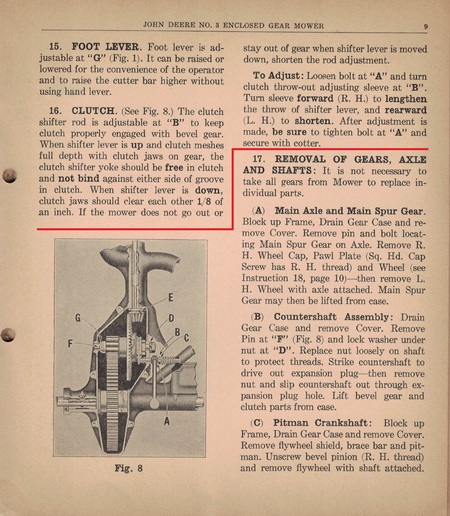

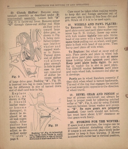

"I was wondering if you could help me out with how the gears come apart"
Reviewed the Directions For Setting Up and Operating JOHN DEERE No. 3 ENCLOSED GEAR MOWER (HIGH LIFT) manual under the 17. REMOVAL OF GEARS, AXLE AND SHAFTS topic on pages 9 - 10.
Hope this helps.
