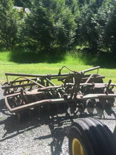

I am going to look at an 8 foot John Deere 3 point disc that for sale on Craigslist. I have a 6 foot "Love" disc with wood bearings that some of the bearings are seized up on (it was that way when I got it), and am thinking that the JD disc could be a replacement. My tractor is a New Holland TC 30, and it can lift and pull the 6 foot disc fine (the square shaft is worn round in places so the discs turn even though the bearings are seized), though I am wondering if the 8 foot disc would be too much for it. Wondering if someone here might be able to help answer this. Thanks in advance.

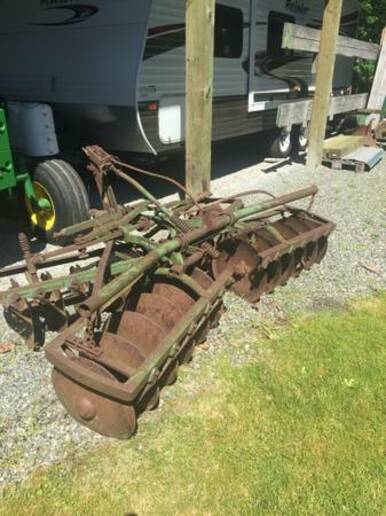

I read on another forum that the manual for the disc says that it can be pulled with a 1010 or larger JD tractor. My tractor is 30 HP 4 WD. Would the 4 WD make up for lesser HP of my tractor in pulling the disc? The disc looks to be in good condition, though some of the discs themselves are a bit worn. If it's a "finishing disc" what exactly does that mean? Thanks for any information on this.
Here are a couple more photos of the disc:

Due to the fact that disk in photo has the rear lift pipe I think it's a 7' model KBL

The KB series of disks I thought was one of thr best disks ever. A lot don't like them tho. That is a flexiable disk and 7 blades would be an 8'8" disk, a 6 blade would be a 7'6" disk. You always measure width on back gang. That Love disk just take the bearings apart and clean them and put back together and repair or replace that axle. Now I think that Love disk has a wider blade spacing than the Deere so a 6 blade Love just might be wider than a 7 blade Deere. That 6 or 7 blade is number of blades per gang or on a side for a 7 blade having a total of 28 blades, a 6 blade 24 blades. I forget the blade spacing on the Deere but if I remember correctly it is 7.5" and I think the Love is 8.5 or 9" blade spacing. So being same weight a Love would be more of a heavy tillage disk and Deere more of a finnish disk. That Love disk is a big rarity as in my 76 years I have seen only one but I have had 3 KB series disks. 2 KBA drag disks 6 on a side and a 7 on a side wheel carried KBA disk. Pulled them all with a late John Deere B tractor. 28 MAX PTO HORSEPOWER. I have no idea what that New Holland tractor is. And that Deere could be with grease type steel bearings or later were avaible with sealed bearings. KBL is the model number for the Deere disk but I think they had different model not neere as popular that I don't know model of. Deere should have 18" blades but still work with nown to a d15" blade but pull harder and do not work as good. I think anything under 17" on that Love is totally wore out. The Deere the gang angle is adjustable, don't know on the love.

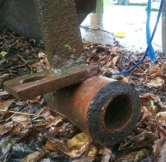

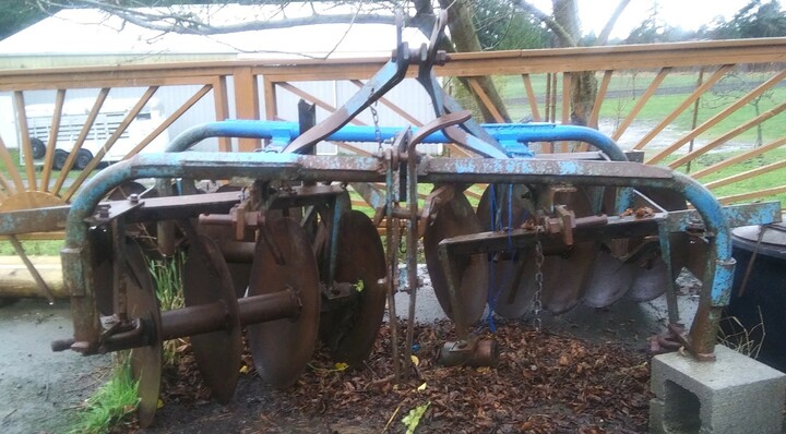

Here are a few photos of the Love disc. I had removed one of the gangs to see if I could get the bearing out of the housing, but I was not able to. I am not sure why there is a round metal pipe inside the bearing, when the shaft is square.

That is the spacer for to hold the blades in position same as the spacers between the other blades.. Supposed to turn the wood part of the bearing on outside of that spacer.

As Randy said an 8 footer is a lot of disc, but that one is relatively a lighter one It is not very aggressive and is more of a finishing disc than a leveling or cutting disc.
