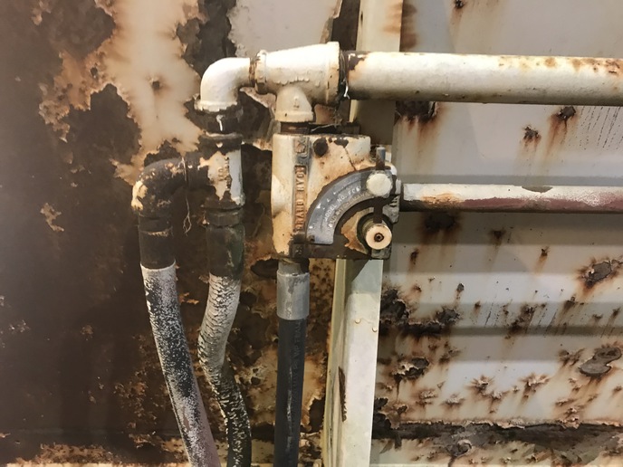

thanks for the tips on check spread rate destroke , 504 and showcrop . it has one flow control on this and it still has parts of the old truck controls left on. when I get closer to being ready to use, I will do some repluming has it has 4 places it send fluid back to the return line, I think I may add another flow control if needed but the spinners as long as they are fast enough it should matter or am I missing something here. also have the bed chain in the barrel with the de-rust compound and this stuff works slow so will be in there a few weeks. working on some weld patches to the back panel this past weekend as were the gate when up and down need a patch plate put in. and the 706 I hope to have done by new years, I think I striped and repainted everything on the tractor, the hardest job it will ever see is the grain auger in fall.

All of the spreaders that I have used have constant spinner speed. It is only the gate opening and apron chain speed that vary. One that I used to use had the apron chain driven by a small wheel that you lowered down onto one of the tires so that apron chain speed was synched to ground speed. That one was primarily for fertilizer though.
