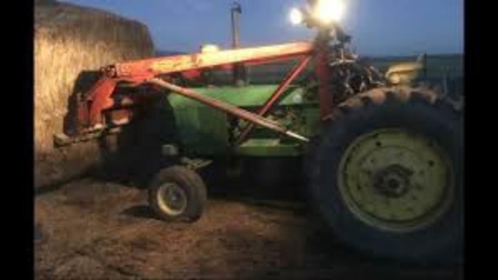

Took a look at it this morning. Nobody home but I found it hanging in a lean to. Real nice condition but the 4020 was out of sight so I couldn't see the side brackets. Going to look again tomorrow. Now that I've seen it I think it may go on the Ollie OK. Does anybody have pics and dimensions of the side plates?

Thanks JD but it's an Oliver 1550 RC. Two large mounting surfaces on each side with 3/4 threaded holes. May just be doable.

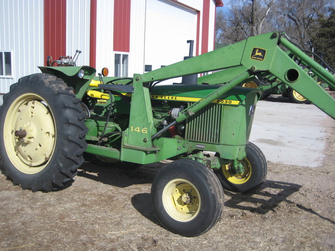

Mike I hate to rain on this idea but the JD 1550 you have takes a different mounting bracket than the one that would mount a JD 148 loader on a JD 4020. The current one he has does not have axle brackets and it also does not have the plug of steel on the front side rails that fits into the hole in the casting on the front side of your tractor. Also the JD 148 loader is longer and bigger than the loader for your tractor. The JD 148 bracket will interfere with the front axle too. (IRC)
Your tractor would have taken a JD 146 loader with utility tractor mounts. Also your tractor will need the side panels that go from the front casting to the clutch housing. These look like six inch wide, half in thick, flat plates that take the stress off the engine block.
I know you can "make it fit" with a torch and welder but you will have to have the rear axle supports or you can break the clutch/transmission housing on the tractor. The JD 148 loader is a longer loader too an this will put the loaded bucket further out than the JD 146 loader. So you will have less lifting force.
JD utility tractor with a JD 146 loader. Look at how the bracket goes under the foot rests and extends back to the rear axle. Also how the bracket stops and does not go past the cut out for the front axle. (This could be different on your JD 1550, just the front axle cut out, the bracket would still go back to the rear axle.)
Here is a JD 148 loader mounted on a JD 3020. This is the same mount as the JD 4020 takes. Look at how the bolts are in a straight line along the tractor frame rails. Your tractor does not have these frame rails to bolt too. Look at how the bracket goes up and over the front axle too. It is a totally different mounting than the one a JD Mannheim built tractor takes. Also notice no axle supports/brackets.
