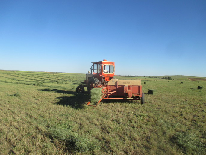

So I baled around 100 bales today. It was hit and miss on the left hand knotter. Twine is not being cut off the bill hook like it should be. I think I need to sharpen the knife up a bit more. Odd thing is it was doing just fine and would miss one out of say 10 bales then all at once it got to where it was missing most. Oh well such is life with old machines

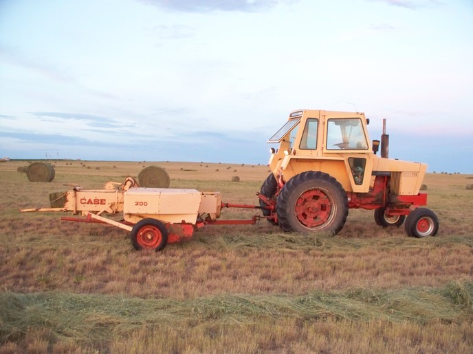

Thought I was the only one still running an old case baler. Got a 200 that my father and I bought used in the late 60's. bought up all the old ones i could find that were junked to have for parts. it seldom misses a bale since I switched to the plastic twine. The sisal you get now is junk anyway. The biggest problem I have is shearing pins. The bushing in the flywheel is rough around the inner end and

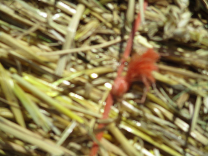

I'm pretty sure it is a dull twine knife since the knot stays on the bill hook. It is cut but not all the way cut so it hangs up on the bill hook

Reason I think it is the knife is the fact the knot is cut but not cut all the way so it hangs on the bill hook

Knot is only cut part way so the bale then gets pushed back so the knot then breaks what did not get cut. Since it is only me it is hard to turn the flywheel and watch the knotter at the same time. I've had this problem before and it has always been a dull knife. Guess maybe I need to pull out th JD 14T manual I have an see what it says. Ya not the NH manual but trouble shooting should pretty much be the same
