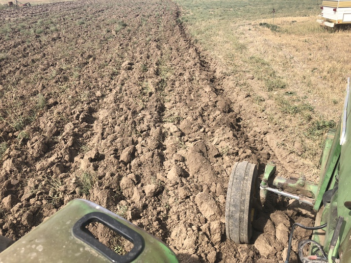

What is burning in the background? You live in beautiful country!

Dale39 they were doing a prescribed burn on some public land .

I have one plow out of 4 that has cover boards and I really like them but I like plowing a little deeper than most .
I think my wheels are set in a bit to far for this plow the front bottom isnít cutting a full cut I was able to adjust the sway blocks on the hitch to allow the plow to be able to move towards the unplowed ground and take a full cut
