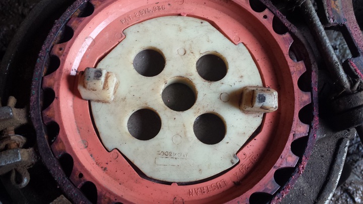

Here are a couple pics of the bottom of the seed hopper. Appears to be plastic plate plus an adapter/spacer(?). A quick search shows they are JD plates. Would it be a straight forward swap to use a different hopper that can hold two different type of seeds -- or would some modification be required? FWIW it is currently set at 30" row spacing (someone mentioned measuring).

Thats a, AC unit with the JD adapters.I've never heard of a double hopper planter built by AC.Cole is the only company I've seen build one.

AC planters use a JohnDeere plate with an adapter disk. Order from Lincoln Ag Products.Evergreen Colorado.(303)658-0281

Picture of the seed plate,take the front hopper off and turn it upside down if its an AC plate it'll come right off little piece of metal holds it in place.Cole planters in my area are pretty common with two different compartments and plates in each hopper to be able to plant two different seeds at once.
