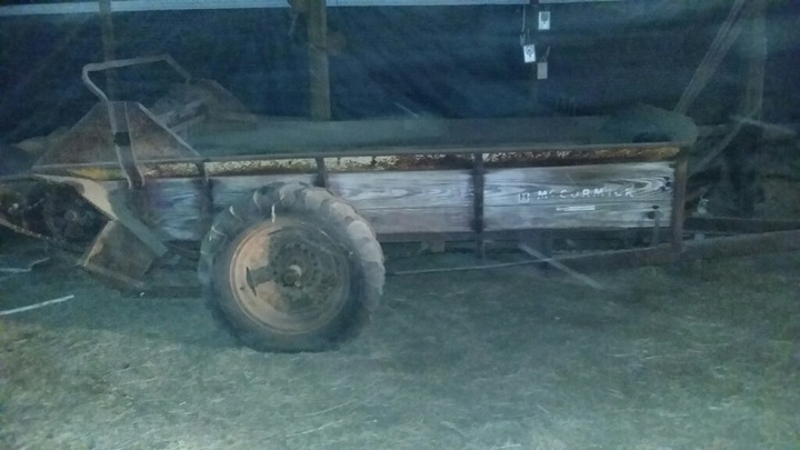

It apears to be about what would be called a 95 bushel size acording to Deere. I think the New Idea that compairs would have been called a 90 bushel size. As for operation speed how fast do you walk? About the speed of a draft horse and that was the speed spreaders were designed for altho the will work god at 1.5 times the horse speed. Just don't go to 3 or more times horse speed. A lot of older tractors horse speed was equal to low gear but some tractors it was equal to second gear. But you do not have to use that low of a gear just keep throttle mostly closed as long as you have the power to pull it. And 2 draft horses will handle a spreader of that size.

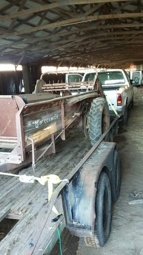

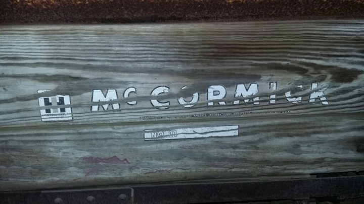

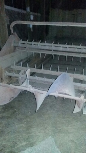

Thank you for your patience. Yes new to a discussion forum and very limited knowledge of tractors or implements. But yes it is an IH McCormick Model 21. There are owners manuals for such a creature on EBAY saying copyright 1955 or 1957 I can't remember which but if important I can google it again. The spreader is ground driver with two large wheels. It is a pin hitch but We do feel the hitch has been replaced everything else looks original.. I've searched the internet but can find no other information other than an users manual and a Pricture stating it was of an tractor loading an IH McCormick spreader model 21. It says the right side of the unit IH McCormick Model 21. That is all the information I had on this spreader ni

You say you feel the hitch has been replaced, that would explain why the levers were taken apart and not put together correctly. You will have to be able to take apart again and put the pieces back where they belong instead of on opposides.
