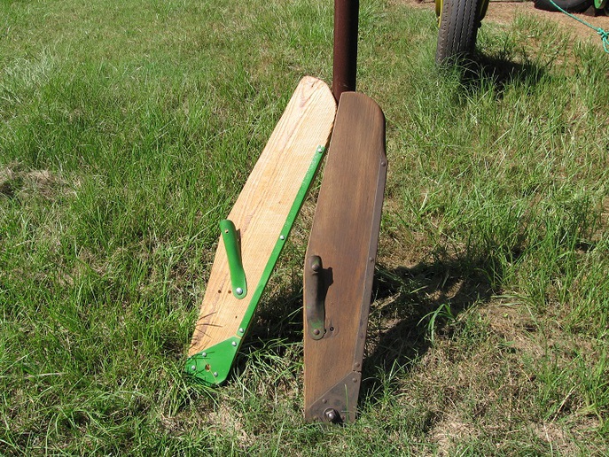

SVcummins
02-02-2018 22:10:53
Report to Moderator
 Re: Finally started on the mower in reply to SVcummins, 02-02-2018 16:50:54
third party image
Is there any reason I can’t use a grass board from an ih mower on my John Deere ? I know where a new old stock ih one is
[Log in to Reply]  [No Email]

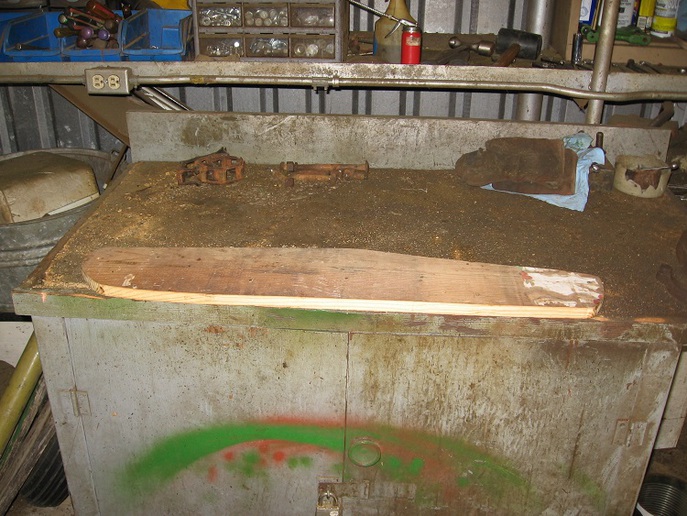

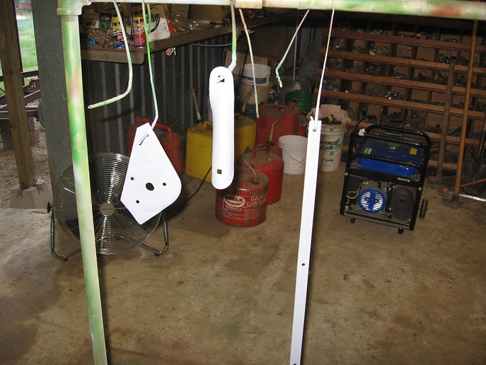

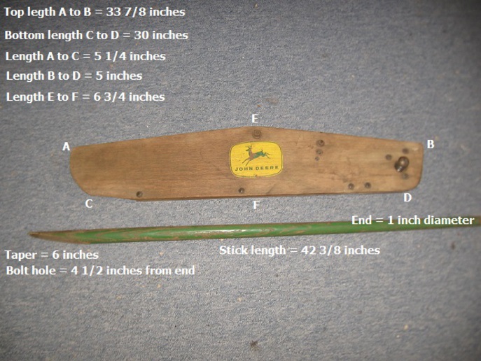

James Howell
02-03-2018 12:17:57
Report to Moderator
 Re: Finally started on the mower in reply to SVcummins, 02-02-2018 22:10:53
"Is there any reason I can’t use a grass board from an ih mower on my John Deere ?"
None.
You might consider building a grass board.
Take a look at the photos below.
third party image
third party image
third party image
third party image
Take a look at the photo below of the measurements.
third party image
Hope this helps.
SVcummins
02-03-2018 22:38:56
Report to Moderator
 Re: Finally started on the mower in reply to James Howell, 02-03-2018 12:17:57
Thanks for posting that I may try building one
