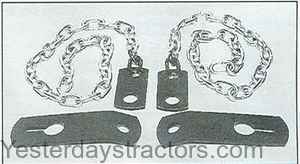

I thought 8N's had position control and the 9N and the 2N didn't! If you really have an 8N and don't have psosition control, get some stabilizer chains to set the height. they are ~$30 but you can make them if you are handy with a torch and an arc welder. Look in the Parts Section of this forum.

I would not recommend installing casters or any type of wheels on the front, if they ever get bent under or fall off, the cutter blade could launch them back at you, or get tangled up under the deck etc. Better off with some limiting chains like was shown. I would imagine if they were stout enough and firmly attached, say pipe inside of pipe, with adjustment hols, welded to the deck might be ok, but, you don't want em ever coming off, I've had a tail wheel get under the deck once, not good by any means.

third party image
i use a height stabilizer similar to this setup on all my smaller Ford's...works like a champ.
this kit is for sale on YT...link below will take you to page but ya gotta scroll down to find it.
