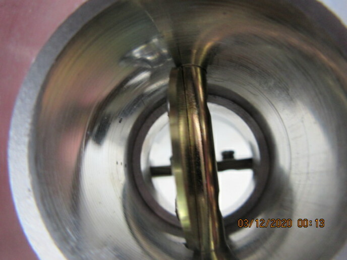

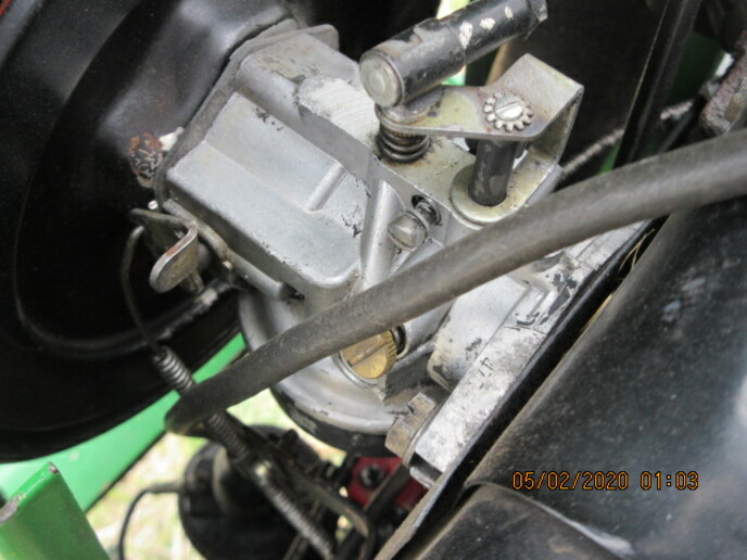

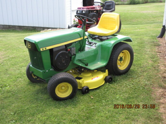

Some people seem to have good luck with that cheap Chinese junk but I didn't. Last spring I decided to treat my old JD 110 to a new carb. and fuel pump. The old pump leaked a little oil past the pin through the rocker arm and the carb. seeped a little gas when it set for a month or so. Other than that it ran perfect.

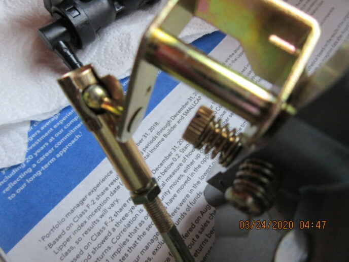

The new carb. was big enough to shove a cat through the venturi, must of been for a 16 horse eng. and I ordered the more expensive one to get the new linkage piece on top because my old one was worn out on both ends. The new one was drilled wrong and wouldn't stay on the ball at all. The Ebay seller didn't want it back so I ended up keeping the new carb. and got 9 bucks back.

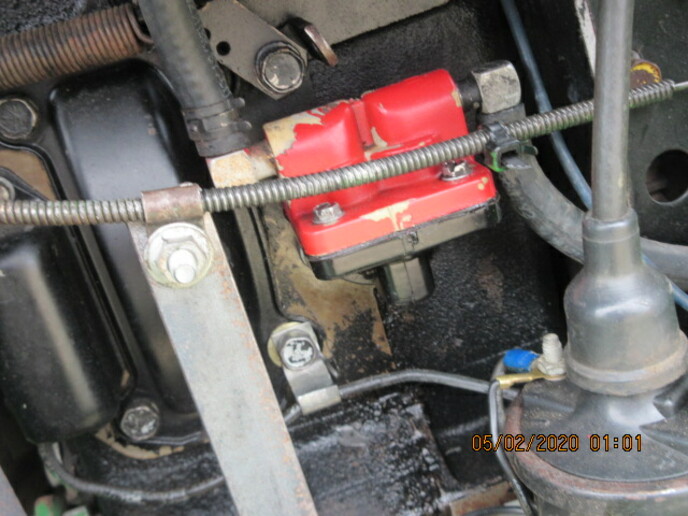

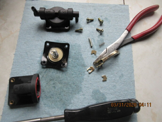

The new fuel pump broke the inside end off the rocker arm after about forty five minutes of run time, seller sent me another one with the same result in a half hour run time. Got my money back on that.
Made my own fuel pump, black/red out of two old ones and found enough parts and gaskets in my junk drawer to rebuild my carb.
