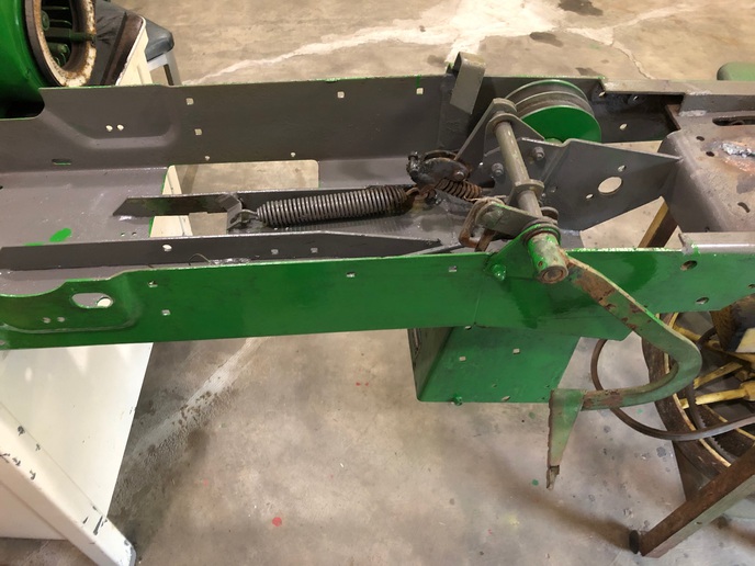

I found that out a few years ago my self. I tried cheap belts and they want work. FYI the part numbers are as follow. Primary belt part number is M82258 and secondary belt is number M44121.
I have this one torn down to the frame, almost ready to start back together.

Now is the time to replace those pesky little detent springs in the transmission.
