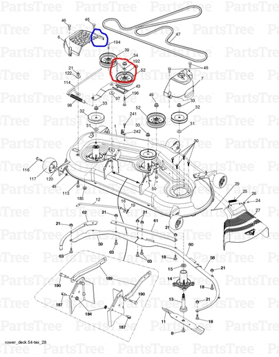

So the local dealer had a LGTH24v54 lawn tractor still in the crate and it was late November and the dealer was anxious to move it out the door.
Price was right so we bought it and took it home in our own trailer. I was still busy combining so all I did was drive it off my trailer and right into our shed.A week or so later my son says he wants to try it out and maybe blow some leaves off the front lawn. I was not there but he said he went maybe 5 minutes and it thru the mower deck drive belt off and it jammed tight under the safety guard panels. He freed the belts up and was able to string the belt back thru the pulleys and when he tried it the 2nd timed, again the mower deck drive belt jumped off the pulleys. What do we have here,did the dealer install the wrong belt, tensioner, what the heck is going on. Anybody run into this same problem?

 Re: 2017 Husqvarna LGTH 24v54 belt comes off in reply to Jo-ker, 01-07-2018 08:36:07
third party image
Bought a GTH2754 in 2004.
Belt shredded within a few hours of operation. Dealer came out and installed a new belt. Before he left the new one shredded.
Upon close inspection we found two things.
1. The belt was not placed between the pulley and belt guard on the tension idler. (marked in red)..
2. The belt was rubbing against the belt guard on the deck. (marked in blue). Used an angle grinder to remove enough material to give the belt approx. 1/2" clearance from the guard. Installed a new belt and ran it for almost five years before it wore out..
Replaced the factory belt with a API Products A-88667 K belt from V belt and it is still running as good as a new factory belt.
alighnement issue thats nothing unusall out of the crate. seen it lots time, dealer has to setup alot of times to get it correct. check you alighnment.
It sounds like you need to get that mower back to the dealer and let him try to figure it out.
Now that the belt has jumped once, likely one or more of the cords in it are broken and from now on it won't stay on period.
If the dealer can't point to some other part of the mower as the cause of the belt jumping, you may just have to buy a new belt.
Being your son was blowing leaves, you can check all the pulleys for debris wedged in them and under the covers. Also, if the front of the deck is excessively low, it makes the belt ride near the top of the idlers where the belt goes up to the engine. Excessively low meaning the blades are 1/4" or more lower at the front than at the rear.
