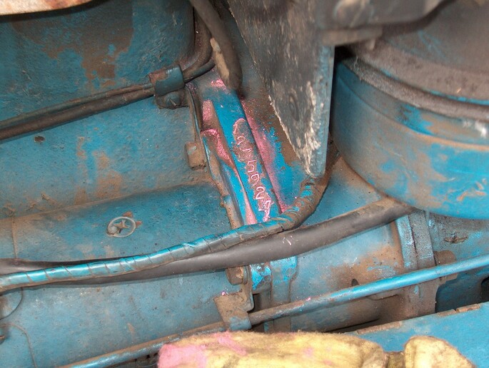

I bought this site unseen on an on-line auction. It's supposed to be a '53 but I can find no serial number. Runs good, tires are good & tin is very straight, but almost no paint left. Plan is to take the one dent out (yes, there's only 1!) & paint it pretty.

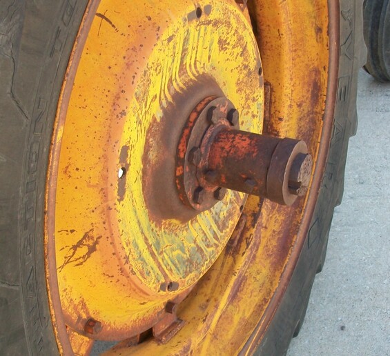

3. The right rear axle looks really strange! It's been cut off w/a cutting torch & is much longer. The rim is mounted on the inside making removal almost impossible!

Wish I knew half what you guys know about these Majors! I just checked again & there are no numbers in either place, stamped ot raised, but on the other side below/behind the injector pump is E1ADDN6015 w/T2 kind of below it. Does that help any?

Majorman
10-01-2023 01:42:48
Report to Moderator
 Re: '53 New Major? in reply to Lynn Patrick, 09-30-2023 14:20:50
No, that is just the moulding number and will be the same on most Majors with that engine. It seems that no-one transferred the number when they put a new block or engine into her, however the casting numbers like the one you found are on all the cast parts. They will be on the front axle, rear axle, lift (possibly under the seat), so that will give you the dates on all the main parts. Engine wise, there was little change between 1954 and 1962, and after that it was only things like the pump and cylinder block. All the main parts are interchangeable back to 1952 with few exceptions.

 Re: '53 New Major? in reply to Lynn Patrick, 09-30-2023 08:58:12
Thanks Majorman. I can find no number anywhere! Nothing above the gen-dynamo, & no plate near the battery area, only some holes where one may have once been!
The T handle enters just behind where the top radiator hose connects to the head.
The # by the clutch is M26U????? ?

Majorman
09-30-2023 13:53:12
Report to Moderator
 Re: '53 New Major? in reply to Lynn Patrick, 09-30-2023 09:52:06
M26U is October 26 1953 but as Emiel says, a closer look shows a modified engine with no ribs dowwn the block so it could be an exchange engine or new block fitted at some time.

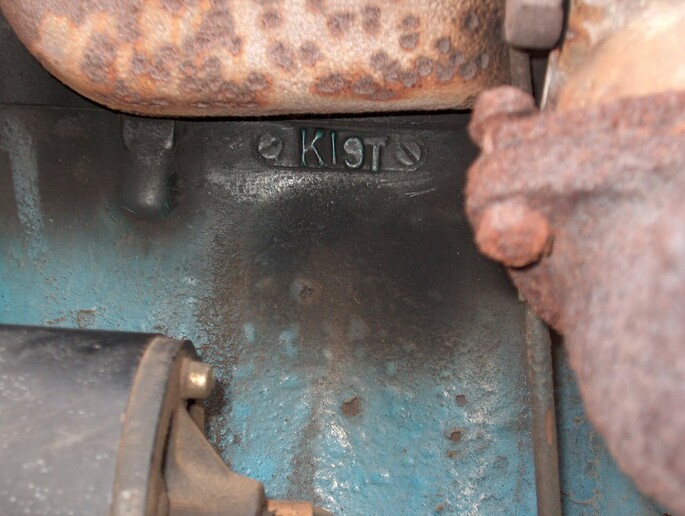

Majorman
09-30-2023 09:22:15
Report to Moderator
Certainly an early one so 1953 could be right. The serial number will be on the flange behind the starter and, possibly, on a flat plate on the battery fire wall up near the bonnet hinge.
Axle looks strange, should be knock-in wheel studs, never seen one like that. As for the 'T' handle, could be the engine stop was my first thought.
If you look on all the cast parts there will be a casting code like A24B. The easiest one to find is near the clutch pedal pivot on the selector plate. If you post it we can tell you the day, month and year. Usually about six months before you got it over there due to shipping. The one on the engine is above the dynamo, under the manifold with another on the cylinder head near the manifold.
