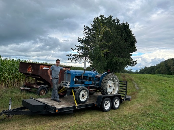

... when you can own three? My third gas major followed me home today. I bought it site-unseen a few weeks ago because it was so cheap - It was well worth it even if just for parts. Thus far I'm quite happy with it: I haven't tried firing it yet, but the tin is in excellent shape and every bearing and steering component feels tight and like-new. The engine has decent compression and is soaking in sea-foam right now. The only problems are the lousy Tremclad paint job someone's given it and rust holes in the fuel tank. I'm not sure why the tank is so bad; the rest of the tin is mint - not a spot of rust nor bondo. But I can put my finger through a couple of spots on the top of the fuel tank. I'm guessing it was never filled more than 1/2 full and rusted from the inside out due to condensation.
Overall, a pleasantly surprising day for me. I know the gas/petrol Majors aren't too common, but I've seen quite a few here in Canada. I suspect they imported here for their cold-weather starting capabilities.

Nice Fordson if thats it on the trailer . Fuel tank I think condensation , moisture in it was acid ,

Nope, not all of them were dual-fuel. Majorman would know for sure, but I believe there were initially three versions: An 'all-fuel' (kerosene/paraffin & gas) version, a petrol/gas-only version, and a diesel version. The all-fuel one soon faded out - kerosene was only popular because there was some sort of a tax incentive for kerosene in Britain (Actually, I don't think it was a 'incentive', it was rather that kerosene wasn't taxed?). When Britain got rid of that, there wasn't much point to keeping the kerosene option around. The gas version faded out with introduction of the Power Major: Fordson had done such a bang-up job on the diesel that everyone was going for that option instead of the gas. Majorman posted in here a few weeks ago that the gas engines were still made/available in small numbers (he had pictures of a Super Major custom-ordered with the gas option), but much less common.
I'd be curious to know if there was a large shipment of the early gas majors to Canada: Most of the ones I've seen (including two of mine) have the early underslung exhaust, which I understand was changed out to a vertical stack later on? All the ones I've seen over here have had the 'flick' brake latch mechanism, which (apparently) was only on earlier versions. I think there was also a power steering option later on, but I've never seen any of the Major series over here with power steering.

Daniel is correct, the diesel version replaced the petrol/kerosene within a couple of years. No waiting to warm up, you could start and drive into work straight away with the diesel one. Diesel also used less fuel, a petrol/kerosene will empty the tank in less that a day in hard work where the diesel could do a day and a half. Straight petrol's were not used here in the UK as taxes on petrol were so high and kerosene was much cheaper, diesel was not quite as cheap as kerosene but you got more work for your gallon.
Handbrake latch was standard, the transmission hand brake was extra and very good. Problem was when people did not service the footbrakes and used the handbrake instead, it would stop you but could also break the support pins and the inner gearbox housing. Also, if you left it on a couple of notches, the brake plates would over heat and seize up. We always used to grind the first four notches off the hand brake sector, on new tractors to avoid that.
Power steering was a later option but rarely specified, you do not need it. My Major steers with one hand even when reversing, they were one of the easiest steering tractors I have ever driven.

She is a beauty, there were only about 25,000 of those spark ignition tractors made but many hundreds of thousand diesels. At least the tank is interchangeable with a diesel one, so should not be a problem.
