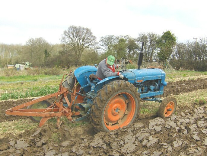

That would be the way I would go. Did just that when I lost a big end bearing around 25 years ago. Got the crank reground to 0.010 thou. undersize, new rings and a valve job and she is still going strong. I started her the other day for the first time for around six months, to chip up some garden waste and she hardly went over one compression before bursting into life.
Third Party Image

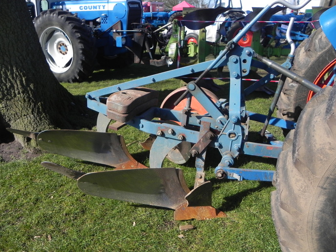

What kind/model of plow is that? A mounted plow with skimmers like that and dual crank adjustment would be a great outfit to take to plowing matches on a major.

That is a Bitsa-Ransomes, bits-a-this, bits-a-that. I bought it many years ago for 12 British pounds, from a farmer who was going to turn it into a Headland Plough. It works very well at burying weeds, I have ploughed in tall grass as high as the bonnet in the past. It was the go-to plough for anyone in the village who were reclaiming rough land.
Will try and find a Ransomes picture more suited to the tractor later.

Third Party Image
This range of ploughs was built for the Fordson Major by Ransomes, Simms and Jefferies Ltd of Ipswich, Suffolk. They ranged from single furrow up to 4 furrow. Ransomes had an agreement with Ford to produce equipment badged and trailers. as the Ford-Ransomes range and it covered wevrything from cultivators, crop sprayers, ploughs
