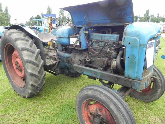

Spark ignition engines finished in the Major range in 1957. However, I have a friend who has a petrol engine in a Super Major, ex factory. It was built as a special order for a company who could not use a diesel engine in a certain application and used the old throttle through the block engine from the early 1950's. That would be 32 hp as opposed to the 55 hp in a diesel Super Major. Engine blocks were available until a few years ago as they were being produced by Ebro in Spain who bought the production line and drawings when Ford cleared it out of Dagenham.
Third Party Image
Super Major with Petrol engine. No lift or linkage and industrial brakes on axle end.

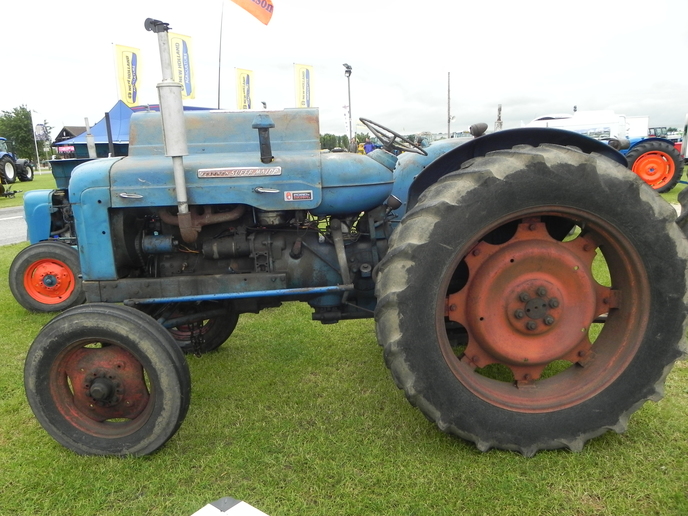

Majorman
08-09-2023 02:44:41
Report to Moderator
 Re: Power Major or Super Major with Gas Engine? in reply to Majorman, 08-08-2023 23:52:16
Third Party Image
Super with petrol engine.
