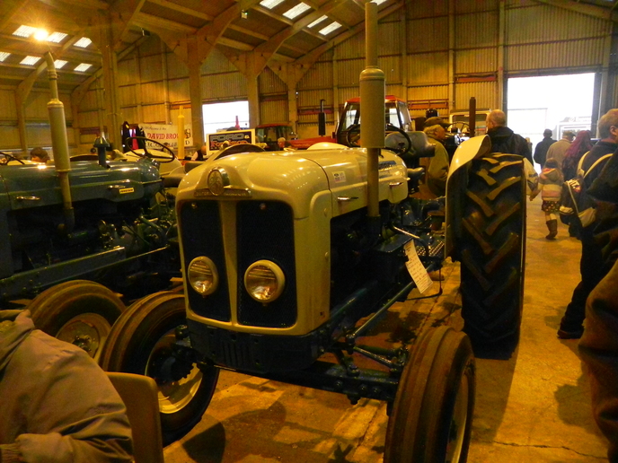

Majorman
03-17-2023 10:36:44
Report to Moderator
 Re: Ford 5000 belt pulley in reply to SkipperII, 03-17-2023 08:46:20
Hope it is a Super Major. :0)
Third Party Image
The '000, X Series Super would not have a pulley unless it was a PTO one.
[Log in to Reply]  [No Email]

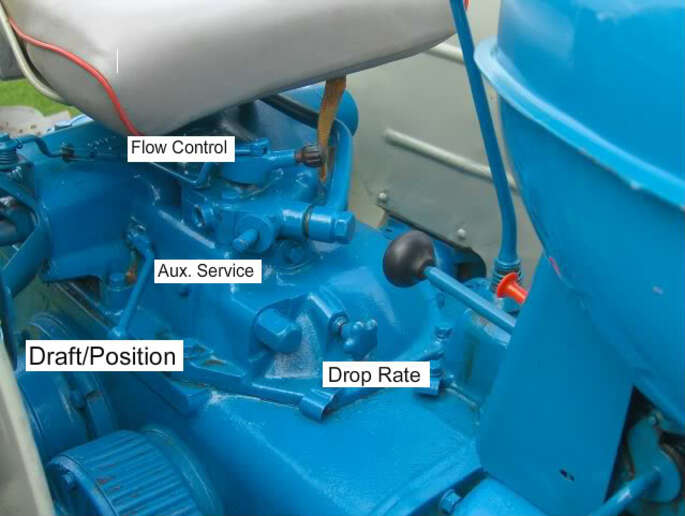

Majorman
03-17-2023 01:29:35
Report to Moderator
 Re: Ford 5000 belt pulley in reply to Majorman, 03-17-2023 00:46:40
Third Party Image
Loader is tapped into the Auxiliary Service chest as shown here. Pulling the knob out isolates the rear lift arms and diverts oil flow to the loader, the loader is then controlled by the main hydraulic lever. Alternatively, if the loader has a separate control valve, then the main flow comes from this port, the lever is lifted to the top of the quadrant and the loader valves used to control the loader. In this case you will need to fit a return pipe to the filler plug on the rear axle.
Your biggest problem may be finding a loader to fit this tractor.
