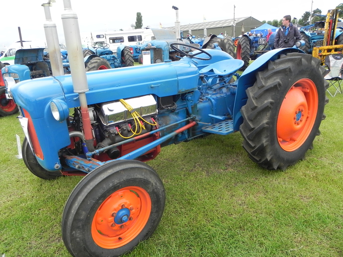

Quoting Removed, click Modern View to seeThe picture looks like it's at a Fordson show. Is that a 302 Ford V-8 in that Dexta? Is it yours?

No, it belongs to a member of the Blue Force Club over here. It is a Mitsubishi, I think.
