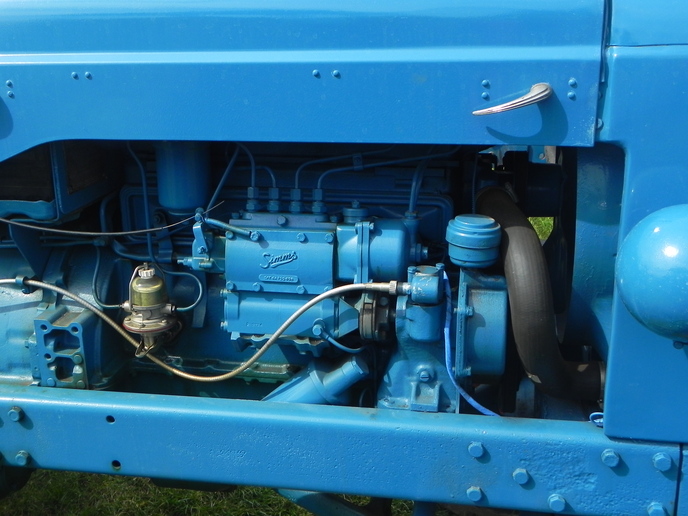

so far, I have been unable to find any inj pump like mine. Simms SPE4A70S380
ANYBODY KNOW WHERE I CAN GET INFORMATION ON IT??
It does not have the lift pump attached to it the lift pump is separate and before the single filter element
Thanks!!

Sorry but your picture is not very clear due to the flash reflection. Could you please tell us what tractor/machine the pump is on.
[Log in to Reply]  [No Email]
Paul Chace
12-06-2020 18:40:47
Report to Moderator
 Re: Simms oddball inj pump in reply to Majorman, 12-06-2020 09:10:58
FSM 1962 with ford 712 loader and 713/723 backhoe
turn over, no start yet
tried to purge air from inj lines, no start
some fuel weeping thru exh pipe, grey smoke
perhaps diaphragm in governor leaking??
check timing on pump to engine??

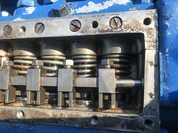

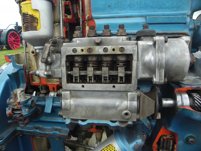

This will give you some idea about what you see when you take the side plate off. You should be able to move the rack with a screw driver.

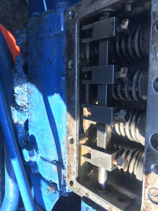

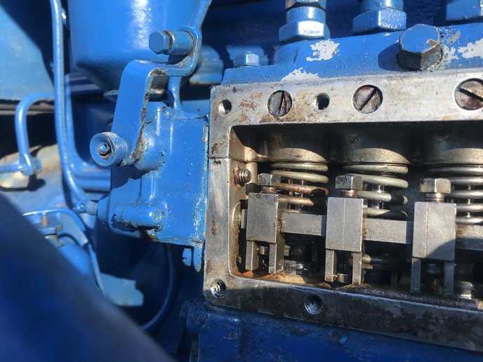

Thank you for the come back I took the side plate off yesterday and was able to work the rack back-and-forth without any issue here are some pictures that I took while I have a cover off little bit of rust here in there

Looks a little dry in there so splash plenty of ATF around. I worked in a Ford approved diesel shop as part of my apprenticeship on those pumps. The only time oil is put in the cambox is when it is put in storage or in a situation like you have. Once you get her running any oil will dilute with diesel and will drain out through the pigtail tube so diesel will find its own level in the lower part of the pump.
