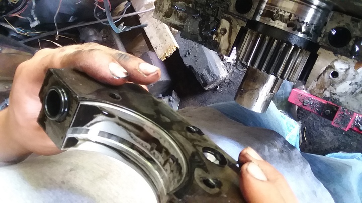

Between finishing up his school year and
helping me with planting, Luke's Dexta
hasn't been getting much done to it.
Yesterday, he pulled the mains and
crank. All journals look good, no
scratches or discoloration, except for
one with a bit of surface rust in the oil
groove area. We'll polish and mic them
before ordering bearings. No ring ridge,
and the one that was stuck started moving
with a couple raps on a pine 2x4. I think
it's a good candidate for a bead hone and
new rings, bearings, and gaskets.
