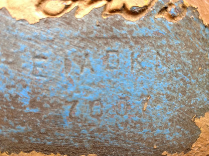

Need help identifying this machine. The serial number plates are unreadable. I have found a few
stamped numbers here and there but nothing that matches, that I can find on the sites. One of the is
EIADKM 7007, EIADDH6B5B G, 13167, M5F, EIDDN-6015L. THANKS in advance Mike
Thank you, thats about all I got from pictures so far. Do you know if there are any other tractors that the parts are interchangeable?
Some limited parts are interchangeable between the 3 Majors series, but no other tractors that I'm aware of.
There should be an aluminum tag on the bulkhead between the engine and battery box, with serial numbers. I also seem to remember there being a raised boss on the top edged of the block, with a machined surface, and numbers stamped on it. Memory gets a little foggy, cause I quit working on them in 1972, on a regular basis.
