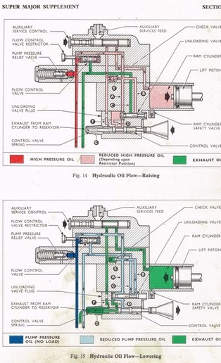

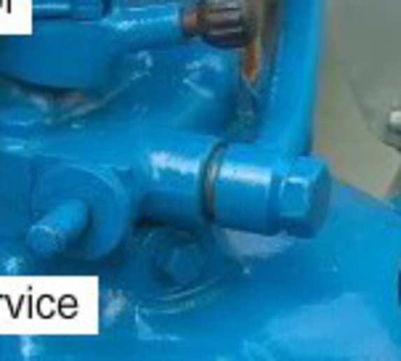

Majorman
11-25-2019 07:06:21
Report to Moderator
 Re: 1961 Fordson Super Major 3 Point Hitch Won't Lift in reply to Majorman, 11-23-2019 01:15:06
Arne,
Can you confirm that you have checked the check valve please.
The check valve is behind the hexagon plug underneath the ASC tapping with the pipe in the picture.
I have included the flow diagram so that if you had not seen it, you can follow the oil flow and (possibly) my thinking. A faulty check valve could help prevent the unload valve working.
Brian
[Log in to Reply]  [No Email]
