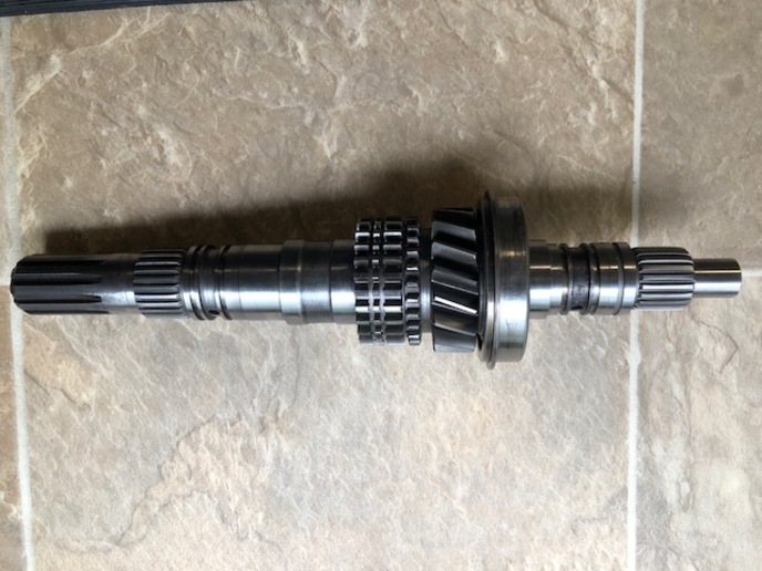

Based on my SN and model, I have a 1970 4000SU with a diesel engine, independent 540 rpm pto and select-o-speed transmission. This tractor has loss of both traction and PTO and based on searches here sounds like it is a failed torque limiting clutch and/or stripped input shaft. When researching shafts and clutch it appears there are differences in number of splines. How many splines should this tractors shaft/clutch have?

Should be a 10-spline shaft for a transmission of that vintage. A 2-speed PTO version should look something like this. Third Party Image

According to my parts book, if it has a single speed PTO, then it should take a 10 spline input shaft, with an original part number of CJPN7B496B. It lists two different spline counts for the ones with the 2 speed PTO, a 22 spline shaft used in North America only from 1/1/65-10/31/69, and a 10 spline shaft used on the European made tractors for all years and North American tractors from 11/1/69 onward.There is also another 10 spline shaft listed for those with no PTO. They are all different part numbers.
The 10 spline torque limiting clutch is part number D0NN7A539B.
None of them are available any longer, nor are the torque limiting clutches. If the splines are stripped, the best way to go is to contact one of the folks that cuts the shaft down to a hex profile and welds a hex socket to the hub of the clutch, if there's anyone out there still doing that.
