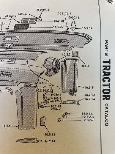

I bought a new set of dog legs for the hood of my 641 . they did not come with the holes for the grill mounting stud . Is this a seprate part or is it supposed to come with the dog legs

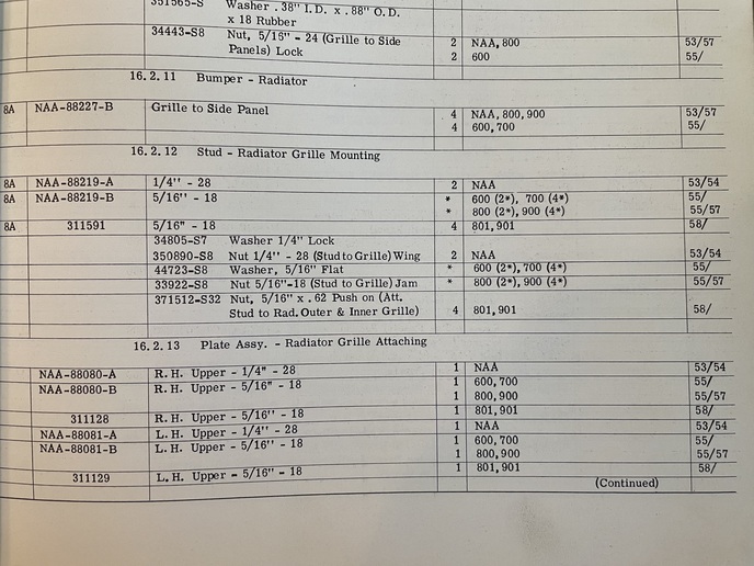

Steve in IL
11-20-2023 13:53:59
Report to Moderator
 Re: 641 grill attacing parts in reply to fran213, 11-20-2023 10:25:46
There seems to be a lot of confusion related to my initial reply. If I understand how the Ford parts books work, you first look at the drawing, and get the reference number. Then you go to the actual parts listing (the second photo I posted), and looking under that reference number, you find your model for the actual part number. Based on that, youll need NAA88080-B and NAA88081-B.
I tried googling the first P/N. Not much there. That might take some time.
Perhaps others see it otherwise.

John P.
11-20-2023 13:01:38
Report to Moderator
Third Party Image
This works with the parts list provided above, but to be honest I don't think it's going to help any further.

Steve in IL
11-20-2023 11:07:25
Report to Moderator
I believe you are talking about the parts labeled as 16.2.13 in the drawing
