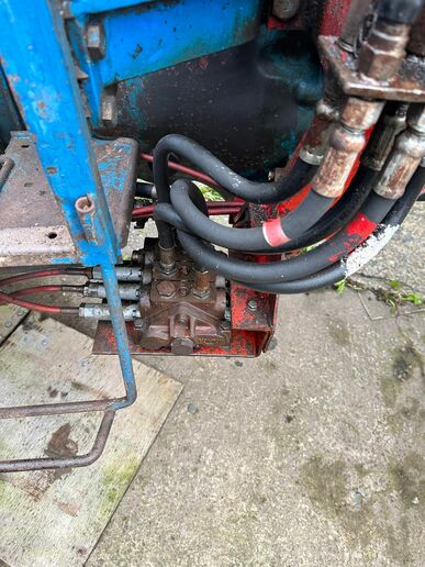

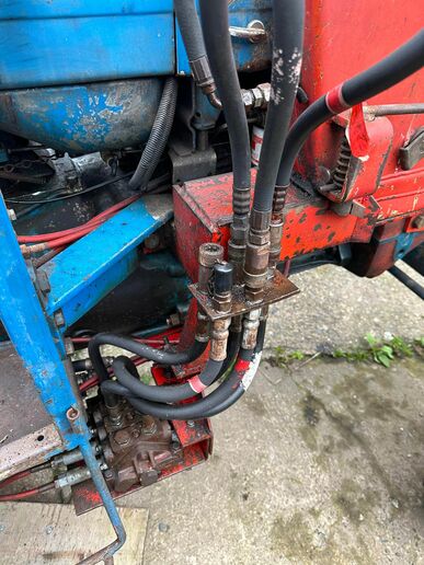

Sean in PA
10-25-2023 07:33:16
Report to Moderator
 Re: Ford 4000 Hydraulics in reply to David Adams, 10-21-2023 14:56:42
Please post a picture of the other ends of those lines that are going from the bottom of those pictures toward the rear of the tractor
[Log in to Reply]  [No Email]

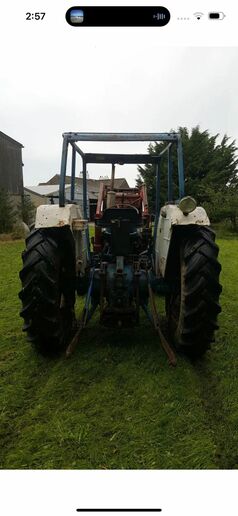

David Adams
10-25-2023 15:10:59
Report to Moderator
 Re: Ford 4000 Hydraulics in reply to Sean in PA, 10-25-2023 07:33:16
Third Party Image
David Adams
10-26-2023 15:35:33
Report to Moderator
 Re: Ford 4000 Hydraulics in reply to David Adams, 10-25-2023 15:10:59
Hi all,
In relation to the last image (the rear of the reactor) there loader is powered by the outlet / tipping pipe at the rear
Destroked 450
10-23-2023 15:12:56
Report to Moderator
Are you able to post a photo of the loader valve plumbing
If the tractor has been equipped with a power beyond block it could be a simple fix

David Adams
10-24-2023 16:09:14
Report to Moderator
 Re: Ford 4000 Hydraulics in reply to Destroked 450, 10-23-2023 15:12:56
Heres the images of the loader valve block / assembly
ATB
Dave
