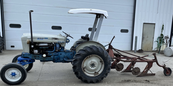

I have a 1961 Ford 961 wide front end with original style wheel weights on both rear tires. I have some hills that I have to mow. Is any company making ROPS for this tractor? Thanks!

Husker 50 8n
09-25-2023 08:45:24
Report to Moderator
 Re: Ford 961 Need ROPS in reply to Randy K. Crump, 09-23-2023 20:11:57
Third Party Image
[Log in to Reply]  [No Email]

The National Tractor Safety Coalition runs a nationwide ROPS program for tractors without ROPS. How it works , as well as availability, varies from state to state. Check out the site at the link below and plug in your information to see if your tractor might qualify.
Link to Nationwide ROPS Program
