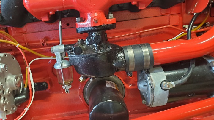

I have a big bowl Marvel-Shebler Carburetor in my 1963 Ford 861. I don't know what the valve is in the bottom of the carboretor toward the sediment bowl side. Is it just a drain for the bowl?

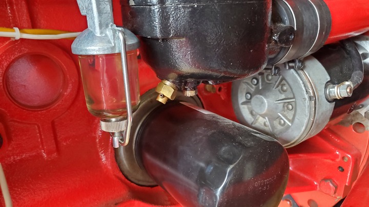

Good idea on the photo...
I see it does have a drain plug also. I am talking about the crew valve in the bottom pointed toward the sediment bowl (Stamped 550). It does not seem to have an affect on the adjustment and I have to remove it all the way to get it to drain.

Tim PloughNman Daley
09-24-2023 05:01:35
Report to Moderator
 Re: Marvel-Shebler Carburetor Drain? in reply to datacommand, 09-23-2023 18:55:50
Marvel-Schebler was the supplier for FORD TRACTOR carbs until the Thousand Series. Parts were relatively the same with differences by the size of unit - larger units used larger Venturis, for example. The Drain Plug on bottom half as Wore Out stated is a 1/8 NPT PLug. Next to it shul be a sintered bronze filter drain for extreme overflow. SEE #17 and #29 on lists. Uses a 7/16 HEX HEAD.

wore out
09-23-2023 21:34:29
Report to Moderator
A photo would help, but most likely you are looking at a drain petcock screwed into the 1/8'' pipe thread drain port in the bottom of the float bowl.
