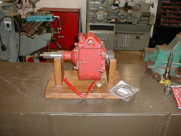

It is a pre transmission.
Fits inside of the bell housing.
The splined end fits into the clutch and the back into the main transmission in place of the regular input shaft.
Having it in there would not change the scope of a regular clutch replacement.

The clutch is the same as on any other NAA, whether it has an auxiliary transmission or not. The auxiliary transmission replaces the original transmission input shaft, so everything forward of that isn't changed, including the clutch, throw out bearing, etc.
