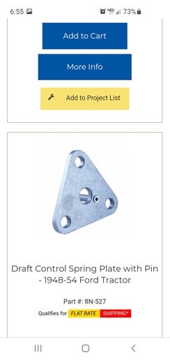

Remove the big draft control spring and the three bolts and the peices behind it on the bolt to the liftchest, get a thin washer that will fit over
the main draft control bolt, notch it for the spacer pin. Slid the washer on the shaft and everything as was removed. May not be according to the
book, or professional, but it works as it takes up ware on the pin that is just ahead of your newly installed washer.. First thing will Probably be a
torch to remove the yoke

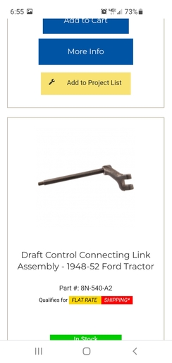

Where did you get the draft control fork?
I've gotten incorrectly made forks before.
Yes, you can compensate for a bent fork with a washer as previously stated.
Dean
That's where I buy mine.
I've gotten bad draft control forks before but not from DC.
Dean
Forcing the washer in ahead of the spring will only compress the spring which will not help the situation
