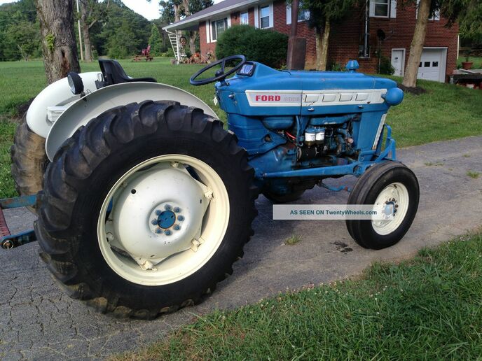

I am new to the tractor world, as I just purchased my first tractor, a 1970 Ford 3000, a few months ago. I would like to add rear wheel weights to my tractor. Though I havent a clue about weights and how they mount. From pictures I have viewed online, it appears that some weights (stackable) attach to the rims and others like pie weights mount to a ring that mounts to the lugs? I see for-sale adds, for Ford wheel weights on Craigslist but dont what, I need to measure on my rim, to make a purchase. Any help/knowledge, on this subject would be greatly appreciated. I have 14.9-28 rear tires on my tractor.

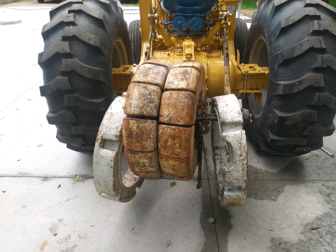

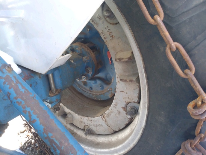

Here is the weights that came on my 3000. (three Ford MOCO rings, 80lbs. per. ring on each rear.)
Gary
Don't understand why that pic. is upsidedown????
Here is the ring part# shown in the pic.
FOMOCO 980E-1676-8
HTH!!!
Gary

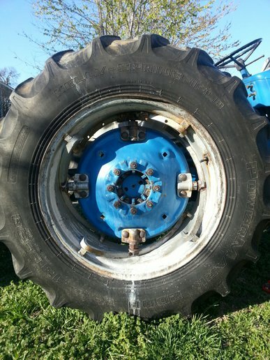

The power adjust rims have 4 rails diagnial on inside rim and have spacer with 9 lugs outside with 8 inside. Non adjust are just 6 loop rims.
Here is what the power adjust rims look like on my 871 gold demo. They are secured to rails using 4 bolts. If your rim has 6 bolts connecting rim to center disc than it's a standard 6 loop rim.
