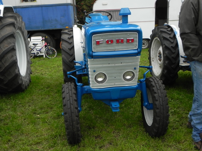

Prior to 1968 this is what you should have, on the 2000 the lower grill would have been blue.
After July 1968 it would be similar to this.

Thanks Fordfarmer. Pic here is what I'm trying to improve on. I know in this pic, the grilles don't look that bad but they look cheaply made and poorly painted in person. Would appreciate seeing a pic of your grilles. But thanks regardless.
The lower grill in the photo is original and came off the first 3 cylinder tractor that I owned. A 2000 built in mid May of 68 iirc.
It is aluminum and has removeable letters.
It has damage and I replaced it with one of those ill fitting plastic jobs. I saved it for the letters.
The other grill is a repop replacement. It is steel and was cheaply chromed.
I don't have a tractor of that era now to test the fit of the repop.
I prefer the pre 5/1/68 style grill. Dunno why. I just do.
