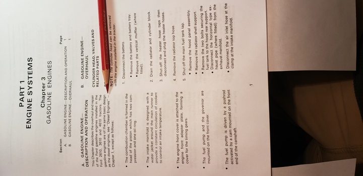

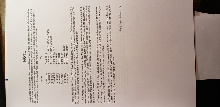

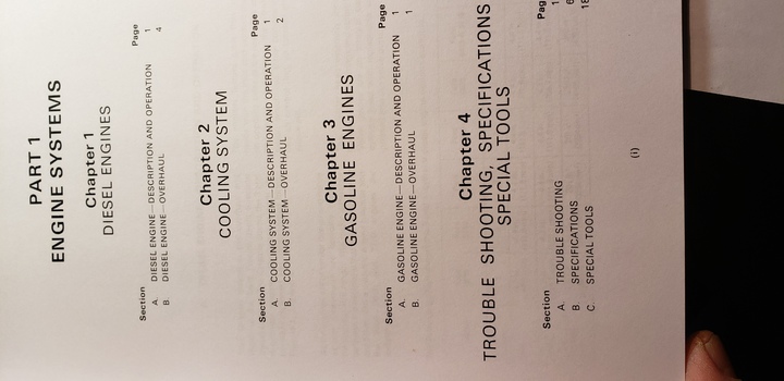

Try from pc, they won't post right no matter how I rotate on pc, for whatever reason, you cannot take photos in "Portrait" and post here and have them orientate the same way. If I take them in "Landscape" you may not be able to read. Save them to your PC and rotate to read easier. Note the information I pointed out. These manuals cover 30 series, with information from previous manuals for older series back to 10 & 00 series.
[Log in to Reply]  [No Email]
Billy NY
03-30-2020 09:11:23
Report to Moderator
 Re: 3930 Rod Bolt torque in reply to Billy NY, 03-30-2020 09:05:52

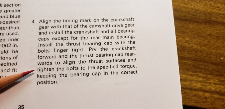

Try in landscape
Bern
03-30-2020 15:48:15
Report to Moderator
 Re: 3930 Rod Bolt torque in reply to Billy NY, 03-30-2020 09:11:23
Your reference to the bolt in this image is in regards to the main cap, not the rod cap.
Billy NY
03-30-2020 16:20:52
Report to Moderator
 Re: 3930 Rod Bolt torque in reply to Bern, 03-30-2020 15:48:15
That is what I was wondering, they don't seem to tell you in these manuals do they ?

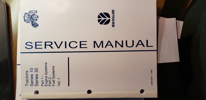

Billy NY
03-30-2020 08:46:05
Report to Moderator
 Re: 3930 Rod Bolt torque in reply to Ultradog MN, 03-29-2020 17:14:40
Jerry, Late, and I'd want Bern to comment, this is what I found in my manuals. This was bugging me, seeing you may not have these manuals.
I'm going to test 1st photo,,the cover, see if orietates right as taken
Bern
03-30-2020 15:46:57
Report to Moderator
 Re: 3930 Rod Bolt torque in reply to Billy NY, 03-30-2020 08:46:05
Billy,
I can see from all of the pencil pointing in your images that you seemed to be concerned about the large discrepancy in the torque values for the connecting rod. And rightly so. You did everything right with regards to the research into this. Problem is, even manufacturers make mistakes in their manuals, and this is one example. Ford (NH) failed to note in the manual the change over from nuts to bolts on the con rods. Ford was never one to be overly concerned about technical accuracy IMHO. Not like Deere anyway.
While a 3930 is essentially a glorified 3910, there is a big difference between a rod that uses a nut versus one that uses a bolt. If memory serves, I believe the nut is 7/16", and the bolt is 1/2", but don't quote me on that. Check out the link below. It is for a 7610 which shows both the nut as well as the bolt style rod. Note that the parts book doesn't differentiate between the two as far as the production date goes. Nice, huh?
Below is an image from the Genesis repair manual, which uses the exact same part number bolt as the 3930 and is to be torqued to 110 ft lbs, which is about right for a 1/2" bolt.
