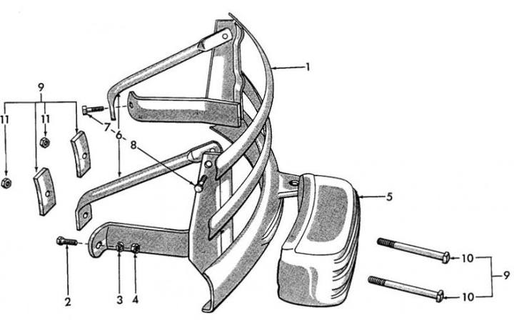

Where can I find an original Ford bumper # C5NN-17750-B for my Ford 841? They were made to slide weights in between rounded bars of bumper.
They don't show up every day and the weights show up less frequently. As for the angle brackets, you might as well plan on making your own though they are out there too.

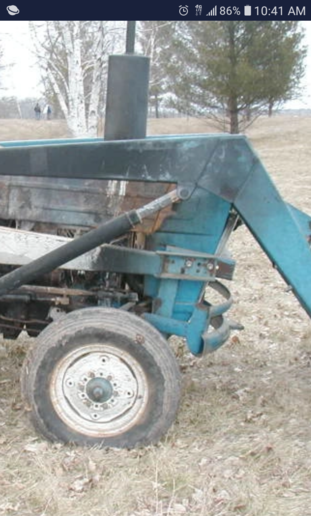

If you are looking for the one for the correct one for hundred series you do not want one off a thousand series. The one for the thousands series was build wider to accommodate the wider square nose tin which is why they have a bigger gap between the top and middle rail so you couldn't mount the weights between them. You need the one that is evenly spaced rails as on my 641. You could probably mount the later one and add two bottom weights, it won't be correct but will probably work. A lot of people won't n
know the difference. here's the later model one on my early 4000

I guess with a little persuasion you can get the later one to fit any tractor but it don't make it right.

I knew about the two different bumpers, the difference in spacing between the horizontal bars and how you can only use two weights on mine vs 4 weights on the 4 cyl ones.
But I didn't know 3 cyl ones were wider.
Your explanation why the upper row of weights can't be used makes sense.
