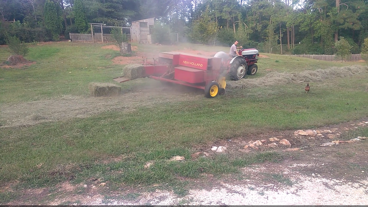

Here's the one Dean was talking about after I did a little cosmetic work and added a few extras. The front weight box and 8 foot back blade topped it off.
