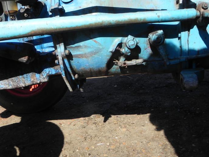

From your picture the clutch adjustment bolt in the lever has been broken off allowing your clutch pedal too much movement and your clevis pin is in the wrong hole, it should be in the second hole for PTO work correctly.
This picture is of a Fordson Dexta but it is the same system. Note the adjustment bolt for pedal height and the two holes in the clevis.
You would need to split the tractor to get the shaft out as the clutch release bearing fork is bolte to the shaft and there is a big spring to release.
