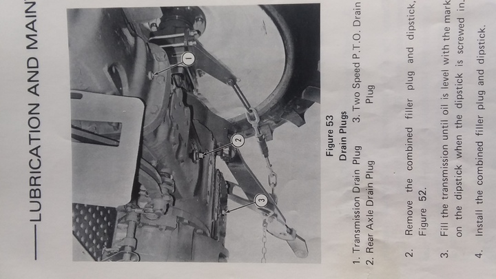

Quoting Removed, click Modern View to see Thanks alot I'll be getting the fluid together. Do you know where the drain plugs are/how many and do I just feel it up at the top of the transmission?
Fordfarmer
10-30-2019 11:02:16
Report to Moderator
 Re: 7600 hydraulic fluid type and capacity. in reply to dbeam, 10-30-2019 10:52:11
Three drain plugs.
Can be refilled either at the top of the transmission or at the top of the lift cover, just behind the seat and slightly right of center. With the common sump, use whichever is easier. My 7600 has a cab, so I use the fill plug on the lift cover.
