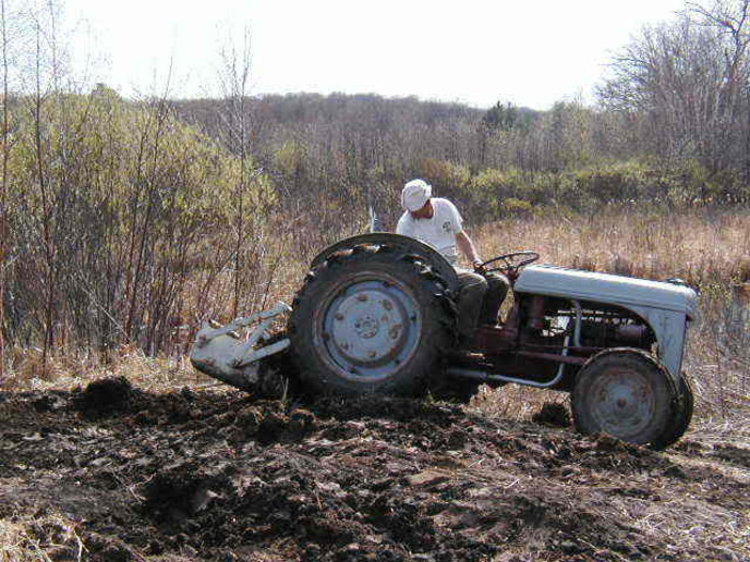

I have a reversable rear scoop (Linebach line) on my 9N and it is much better for digging than the 60" bucket on the front of my 3400 - I have the kids make me a pile with the back bucket (digging in reverse) and I go scoop the loose stuff up with the FEL3400 and put it where I need it. Trying to dig with the front bucket and I dig in too much and spin the wheels.

I like the idea of the rear scoop from an economical standpoint. I found one locally for 150.00. An old Dearborn. I'll look into that and maybe make an offer on it. I think it will accomplish everything I need to do.

I had a Dearborn scoop for a while and moved a lot of dirt behind a 2N that was my first tractor.
Then I found a Ford scoop and like it much better. Primarily because the Ford scoop is reversible and the Dearborn unit was not. I use the Ford one for a carry all as much as any thing - chainsaw, gas, tools, chain, 40 gallon sprayer tank, mulch, etc.
It's much better for shoveling into/out of by hand too.
The Dearborn will do a lot but any brand of scoop that's reversible one will do much more.
